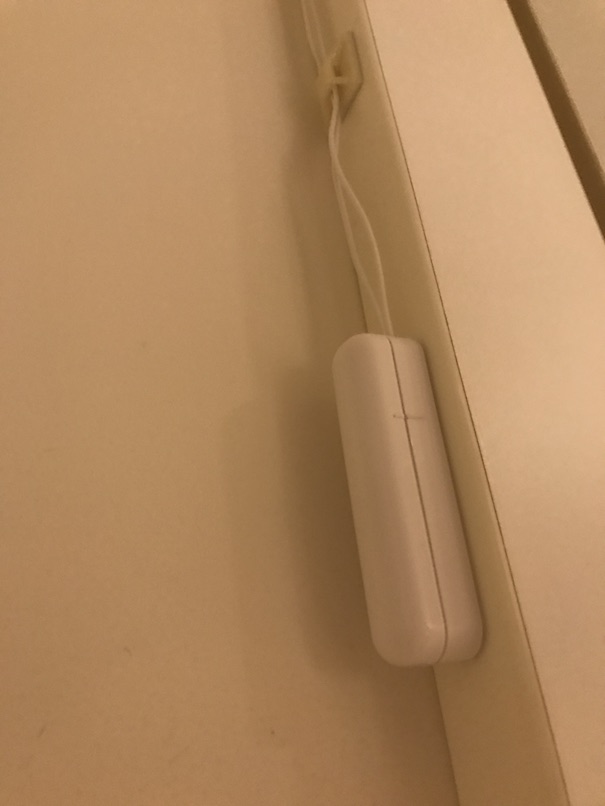

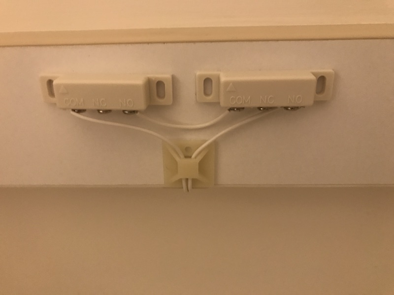

This is my setup:
The FGK-101 has a binary input option, this simply detects if a circuit is open or closed.
I bought 6 magnetic reed switches and wired them in series to form a big loop. If one of the door is opened it breaks the circuit and triggers the FGK-101 binary input.
I did this for all the cupboards in my house, this is the model of reed switch I used:
https://www.jaycar.com.au/n-o-n-c-reed- ... t/p/LA5070
Here you can see some of my reed switches in series:
Here you see the wires going back into the FGK-101 binary input:
Each reed switch cost me just $4.75 AUD, very good price! 8-)
