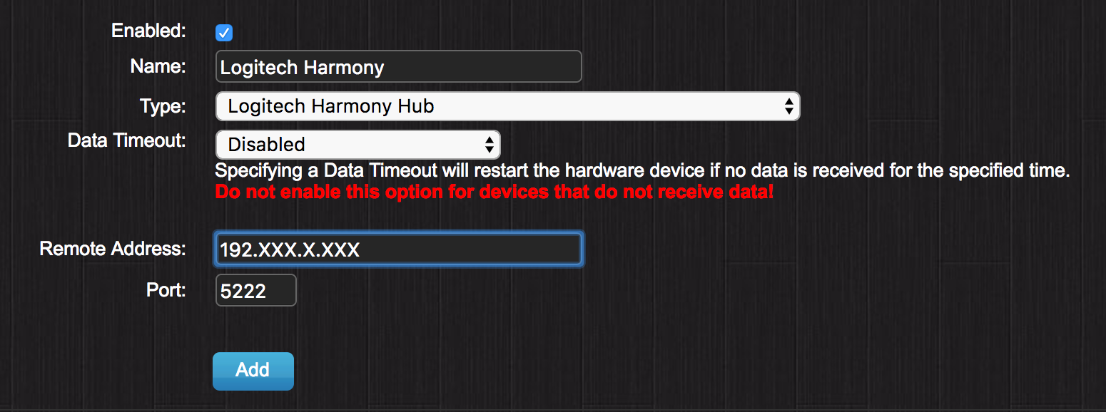

I tried so many things, but somehow I can't get the Harmony Activities to show up in the Devices tab in Domoticz, running on Windows 7 64 bit. I have a Logitech Harmony Ultimate remote with the hub.
The hub is connecting fine as I can see it in the Domoticz log, it even detects when I change an activity with the Harmony Ultimate remote, but I simply can't see any of the activities in Domoticz such as Watch TV etc. or any of the devices used in the Harmony activities:
It has no issue authenticating & logging into the Logitech service (can see it in the log)
I made sure that in settings it is accepting new hardware when I added the hub.
Have also rebooted the Harmony hub, and reset it, re-paired it etc.
Also downgraded Domoticz to 4 previous versions but always the same. Currently running the most up to date version v2.2284
Anyone have any ideas?

I have got the same problem.
- Rasp Pi
- latest stable release domoticz
- harmony all set as hardware
- Login the Harmony service succesfull
- Login to Hub succesfull
- Accept new Hardware Devices selected
- I see Harmony activity changes in the Domoticz log when using the harmony remote itself
But no activities devices in domoticz are added.
2015-03-04 21:44:23.148 Harmony Hub: Worker thread started...
2015-03-04 21:44:23.349 EventSystem stopped...
2015-03-04 21:44:24.586 Harmony Hub: Logged in to the Logitech web service
2015-03-04 21:44:25.860 Harmony Hub: Authentication succesfull
2015-03-04 21:48:03.828 Harmony Hub is changing activity
LOGITECH WEB SERVICE LOGIN : BYPASSED
HARMONY COMMUNICATION LOGIN : SUCCESS
HARMONY COMMAND SUBMISSION : SUCCESS
PARSE ACTIVITIES AND DEVICES : SUCCESS
Activities Available via Harmony :
-1 - PowerOff
13095715 - TV Kijken
13095717 - Mediacenter op TV
13095718 - Xbox op TV
13095719 - Wii op TV
13095720 - iMac op TV
13095721 - TV op beamer
13095722 - Mediacenter beamer
13095723 - Xbox op beamer
13095724 - Wii op beamer
13095725 - iMac op beamer
I checked the Firmware pof the harmony HUB, which is 4.3.48.
Does anyone has the harmony working with that version?

Duan
- Posts: 9
- Joined: Saturday 20 February 2016 8:41
Re: Harmony support, new hardware?
Hi All,
When I try to add my Harmony just like in the wiki, I don't see any fields to add a username and password.
I had this problem on the stable version 3.5837, but also on the latest beta version.
Does anyone else experience the same problem?
Kind regards,
Duan
Kind regards,
Duan

Opentekhead
- Posts: 3
- Joined: Sunday 10 July 2016 4:46
- Domoticz version: 3.6343
Build Domoticz V3.6343 "Beta channel" updated today and I have the same problem where trying to remove the Harmony Hub and re-adding did not show credentials when adding the hardware. I can no longer switch switch the TV off. Probably worth noting that the Harmony Hub is running 4.12.36. There was a firmware update to the hub a few weeks ago which seemed to cause this functionality to break. On another note my Amazon echo works to control it.
