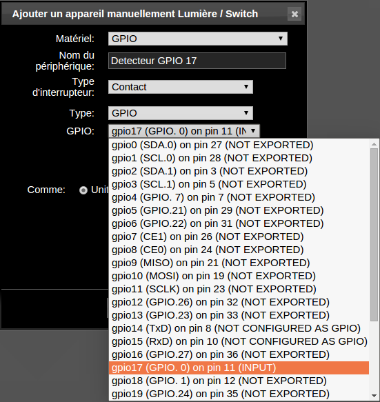

Next step, I configure a new switch "contact" in DZ with the gpio 17.
For inputs
Select the GPIO port hardware you just configured, give it a name, select the "Contact" switch type and a "GPIO" type. You can now select the pin in the list. Obviously, the ones you configured above should not start with the "! NON EXPORTED" mention. Then click "Add Device". The mention "open/closed" corresponds to a switch connected between the pin and the ground, with the pin also connected to a pull-up (as you have read on the wiringPi website, some GPIO have an internal permanent pull-up.
The switch status is always Closed.
When the GPIO exports is 17: in 0 none, the switch is closed
When the GPIO exports is 17: in 1 none, the switch is closed
