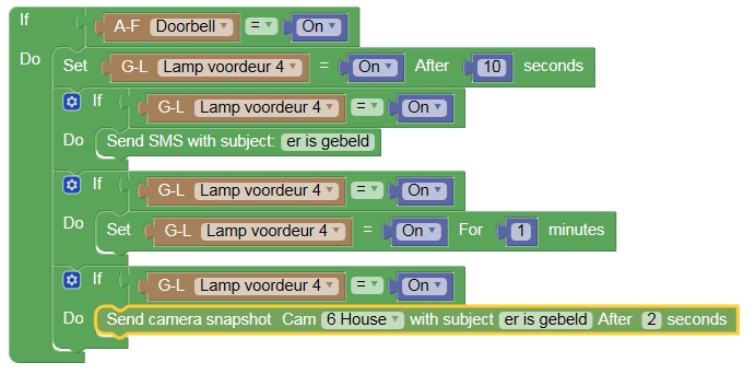

light won't go off
Hello
I'm new here but after a week a junk for domoticz !
So easy but second part wont work
doorbell is pressed
after 5 seconds light goes on
if light is on
send sms with tekst
keep light on for x minutes (here 30 seconds)
send cam snapshot
all well but light keeps on and wont go off !
whats wrong ?
thnx in advance

The nested "If" Blocks are a problem. Can you redo with a single "If" and multiple "Else-If" structure?
The blocks used for seconds and minutes should be integer not time. (6) seconds, not (06:00) seconds.

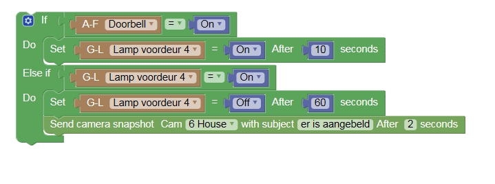

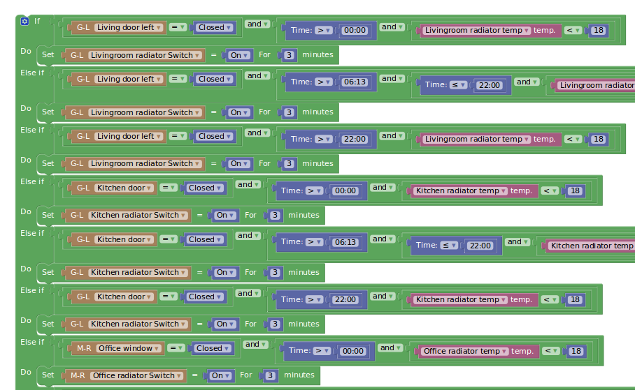

Yes I also have problems with nested if-else/if and have done as StanHD proposed with success, to avoid the nested, take a look at mine as proposal how you can do similar blocklyStanHD wrote:The nested "If" Blocks are a problem. Can you redo with a single "If" and multiple "Else-If" structure?

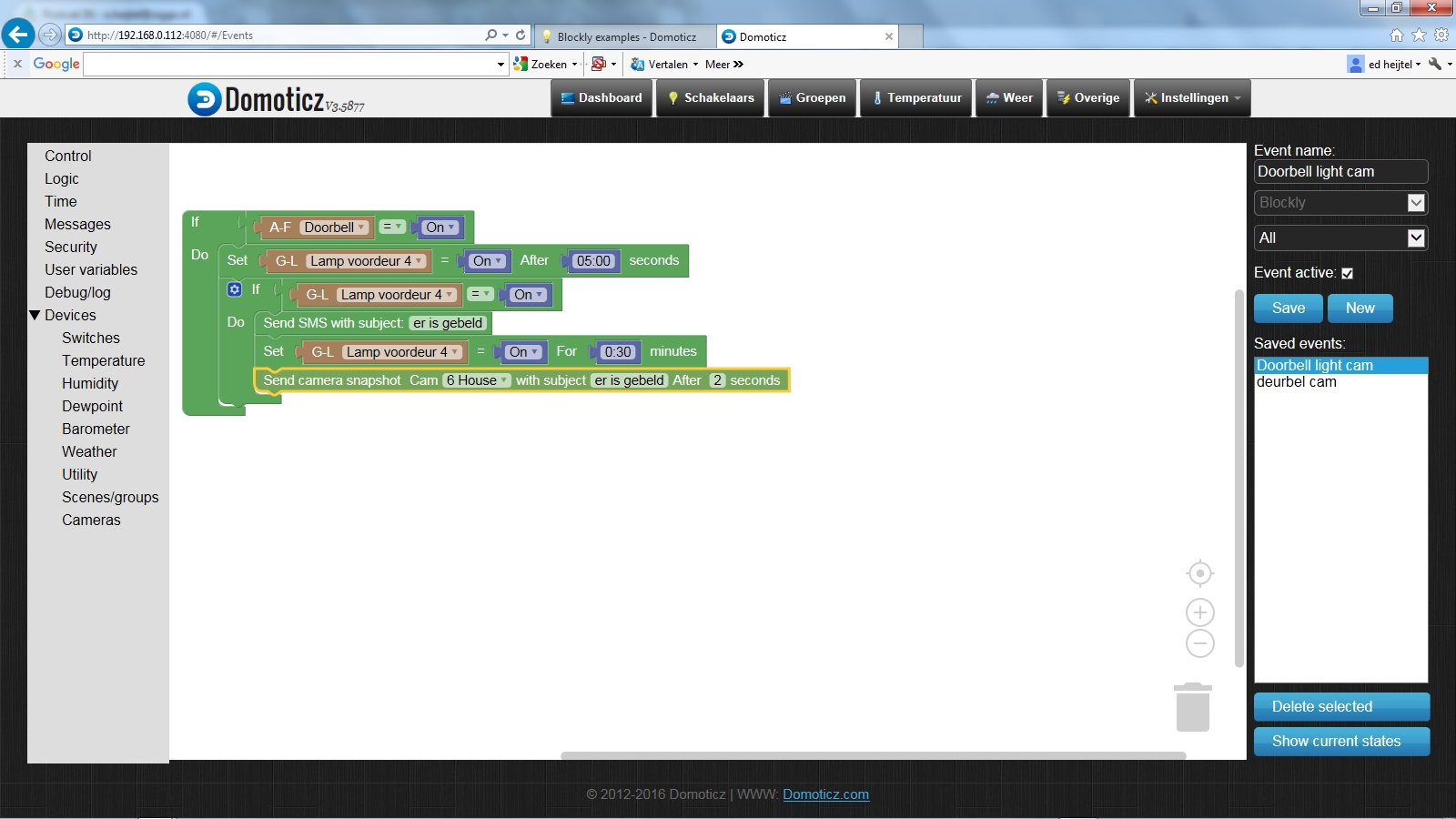

Thanks for reply Stan !StanHD wrote:The nested "If" Blocks are a problem. Can you redo with a single "If" and multiple "Else-If" structure?
Now I have this (see att) :
Script: light goes on immediatly ( not after 10 seconds) and I want a relais of 10 sec
sms has send
camera snapshot has send
light goes off after 1 minute
The starting if (when light = on) is that correct ? if I do when light = off nothing happened; same for all statements so on is logic (?)
but not logic is: when light = on, set light on after 10 seconds (because it's already on). Or what ?
Wait ! I´m struggling with the ´else if´ uhhh
grtz

Yes you still have nested "If"s, try doing as @bjacobse above. A single "If" with multiple "Else if".

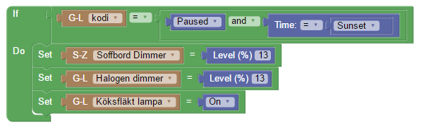

Good morning!
im trying to get some lamps not to turn on during sunrise, yeat active during sunset.
please take a look at this blockly, i cant get it to work.
[img][/img]
[img][/img]

I think the main issue here is that "Sunset" is a time. let's say it's "16:27".
So only when you have Kodi paused at 16:27, it will trigger.
Probably you mean "time > sunset" (after sunset)
Also the if looks a bit strange to me.
look at the previous post of bjacobse to see the difference in the "if" statement.

yes i mean after sunset
so the > should be pointing towards the sunset block?
otherwise, did the setup seem to be working?

Try:- (Kodi=paused) and (Time = sunset)
not (Kodi=(paused and Time = sunset)
Sometimes setting the options on the "and" block to external inputs makes the logic easier to see / understand.

Thanks StanH and of course bjacobse (ignored your suggestionStanHD wrote:Yes you still have nested "If"s, try doing as @bjacobse above. A single "If" with multiple "Else if".
This is working !
Easy and what I wanted !
I will read other blockly's (blocklies) to learn later.

StanHD wrote:Try:- (Kodi=paused) and (Time = sunset)
thanks for your answer, it didnt work, i cant really tell why, i also have a dummy switch that turns on after sunset and of when sun rises.
i aslo replaced sunset timer with the dummy switch, but neither that one worked.
Is there anyone what would like to make a example blockly of how this would look like?
thank you.
