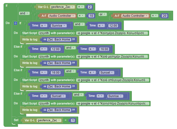

Yes, when the value on user variable is changing using a lua, blocky did not trigger.
About loop: even without user variables, loop can be created.
I have an attached blocky that it reads variables that changed by lua and after reset it (gefense_Zac from 2 -> 1) so to run once the script.
unfortunately , it does not work as domoticz does not check script if variable has changed by following lua.
Edit To be more clear:
virtual switch (TAG Zac) change status triggers script_Tag_Flags.lua. user variable [geofence_Zac] change from 1 -> 2. I suppose that domoticz check changes on variables so it sould trigger the blocky. Blocky script runs the script and reset back [geofence_Zac] to 1. I think no loop can be found here.

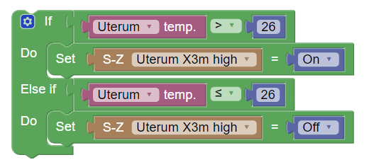

I have problems with temperature values in this event?
If I use one of the others temperature sensors it work but not with this one?
It updates OK from a lua script but it seems not to trigger the event, I have tried with "ALL, TIME, and DEVICE".
