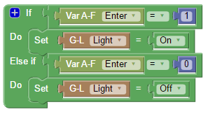

Well my post was more meant like a question as I am new to home automation and Domoticz
But I would think it could look like this.
The two variables is created as Integer and default value 0.
I can see that the variable values change between 0 and 1 according to the program etc. 60 and 120 sec for Exit and Enter.
Can you test if it works in real life
- EntryExit.PNG (41.49 KiB) Viewed 4087 times
- ControlExit.PNG (12.3 KiB) Viewed 4087 times
- ControlEnter.PNG (12.46 KiB) Viewed 4087 times

Re: Blockly examples
@HBrandt doesn't work. I can see that the value changed as you say, but doesn't turn the light. I stayed with virtual switches
regards
regards
Thanks for the feedback. I did some testing the last hour and came up with the same thing.
Is your working code like the three screen shot you uploaded yesterday?
Mvh Henrik
Mvh Henrik
sailmich
- Posts: 245
- Joined: Wednesday 17 February 2016 22:55
- Location: Germany
Yes this works.
regards
regards

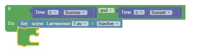

tjabas
- Posts: 562
- Joined: Sunday 11 December 2016 13:51
Hi!
i really in need of some help here.
im trying to set a scene to be inactive during daylight, and the scene should go back to be active during night.
I have read every post in this blockly section but i cant get it at all.
I have a switch that activates the scene, but this is set in the scene programming.
So i want to be able to turn on and of the switch in daylight and the scene wont be triggered, but after dark it will be triggered.
I have tried several settings but none of the work, here´s my last attempt to make it work.
[img][/img]
ignore that block in the bottom, i dont know why it got there.
i would really apreciate some help.
[img][/img]

tjabas
- Posts: 562
thanks!StanHD wrote:Hi,
It may be a good idea to make a "Dummy" Dawn - Dusk switch from the virtual hardware.
Use the in-built switch timers to operate the status using Sunrise - Sunset with delays as appropriate to you.
Then use this switch for any Blockley Scripts something like this?
You can use the Blockley Time Blocks for this, but perhaps this is simpler?
i tried it exactly as you suggested, i made a dusk switch , but it still wont work.
even if it turn the dusk switch off im still able to start that scene i want to turn off during daylight.
tjabas
- Posts: 562
is it perhaps possible to make a switch inactive in blockly during a period of time?

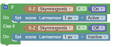

tjabas
- Posts: 562
[img][/img]
I tried that, it didnt work.
i have another switch i domoticz that is called larm, this is aktivated by my bruglar alarm, the alarm sends a 433mhz signal that turns on the alarm switch in domoticz ,this trigger is aktivating the scene that i want to disable during daylight.
when i turn of the alarm when the dark outside the lights in the house will turn on, but the lights wont turn on when its daylight outside.
that is what im trying to accomplish.

what is the name of the switch you don't want to work during daylight?
tjabas
- Posts: 562
Its called same as the scene, larmsensor 1
