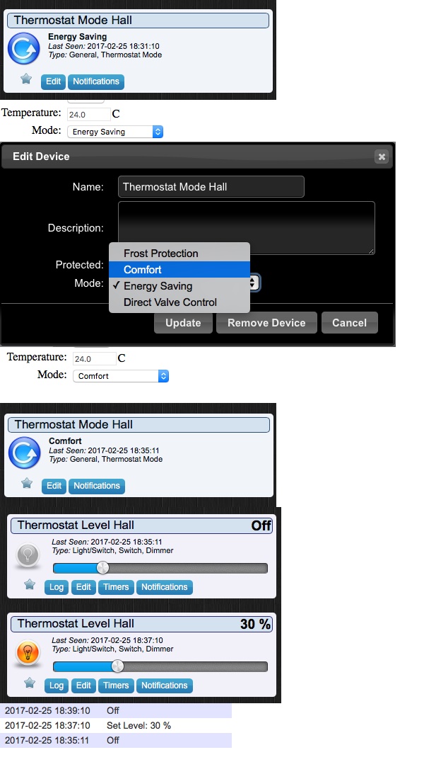

Re: Howto use StellaZ in Domoticz? & Thermostat mode
As a late followup to my post above, I solved all those issues ... the reason the JSON commands were not working was due to the fact I needed to add username and password. After doing that the virtual switch was working fine.
Now when you update to the new version of domoticz a new Thermostat Mode device appears for each StellaZ valve. Cool but ...
There are at least two problems
a) in order to change mode you can't just click on the control. you have to use the Edit button and when you select a new mode and click OK, the interface still shows the old mode until the valve actually synchronizes (or you force it by pressing its physical button)
b) I tried to set up a virtual selector switch to use in the dashboard for quickly changing mode but it is unclear what to use as nvalue and svalue to change mode. It seems nvalue=1 set the Comfort mode and nvalue=0 set the Frost Protection mode (svalue seems to be irrelevant). The values for Energy Saving and Direct modes should be 11 and 31, but these do not work.
Has anyone any idea on how to set those modes with JSON?

Re: Howto use StellaZ in Domoticz? SetPoints...
My observations
JSON
/json.htm?type=command¶m=udevice&idx=...&nvalue=1 - comfort
/json.htm?type=command¶m=udevice&idx=...&nvalue=0 - frost
everything else is not working
upd
/json.htm?type=command¶m=udevice&idx=...&nvalue=2 - Energy Saving
/json.htm?type=command¶m=udevice&idx=...&nvalue=3 - Direct Valve Control
All working
JSON
upd
All working
Sevift
- Posts: 31
- Joined: Monday 21 September 2015 16:02
- Domoticz version: Latest
But a glitch in OpenZWave Control Panel
When you switch to "Direct Valve Control" (nvalue=3), OpenZWave Control Panel will display the mode that you have chosen before. But this does not affect the work.
You need to create a virtual device.
The device Domoticz Thermostat Mode is not working properly

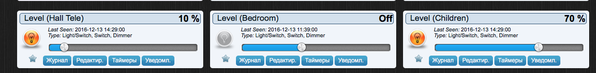

I checked the work in the "Direct Control Valve" mode. Everything works fine.
local tempNeed = tonumber(otherdevices_svalues[thermostatVName])
local tempHum = tonumber(otherdevices_temperature[tempHumName])
setLevel = (tempNeed - tempHum) * 100
if setLevel < 0 then
setLevel = 0
if setLevel > 100 then
setLevel = 100
commandArray[#commandArray+1] = {[thermostatName] = 'Set Level ' ..setLevel}Re: Howto use StellaZ in Domoticz? SetPoints...

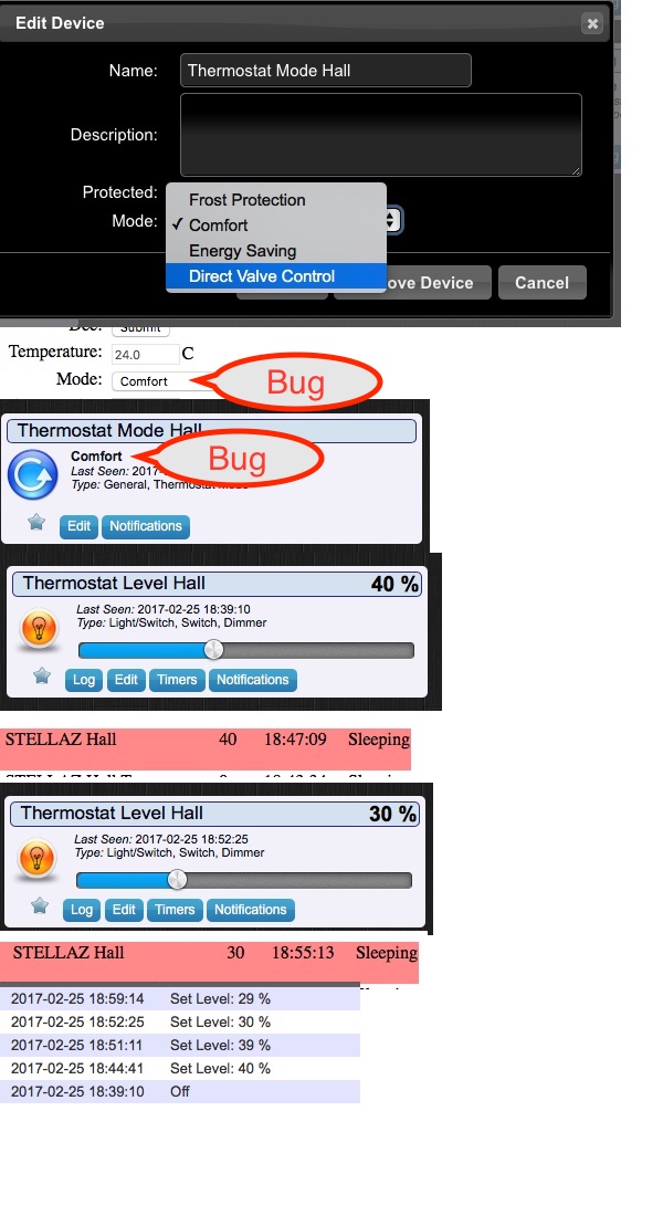

I too wonder about this. I can set all three modes except Direct Valve Control
You're right. It is possible and in a standard way. But the bug is present.
Comfort mode Excellent work - level adjusts automatically.
Direct Valve Control mode Work, level supports manually, but does not change the operation mode visually. However, the thermostat is working properly
I experiencing the same thing, the modes "frost protection", comfort and "energy saving" are working fine, only "Direct valve control" isn't displaying properly but is working untill the batteries are changed, after that you have to set it to "Direct valve control again" as is goes back to Comfort as that is what the controller thinks.
