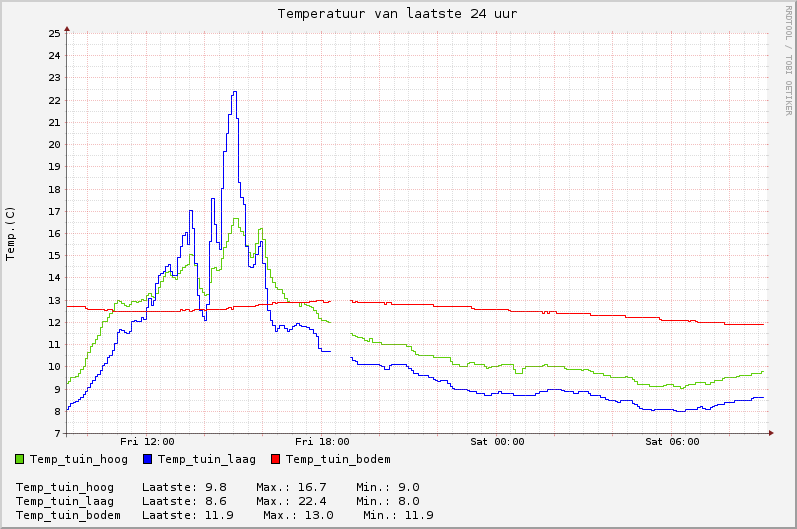

RRD-graph for 3 temperatures

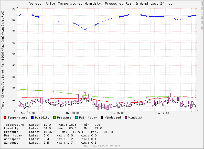

Next step is to 'mimick' the setup as described in ct2017#5 for a weatherstation, but now with temperature, humidity, pressure, rain and wind from TFA_Nexus and BMP180: RDD-update runs, but RDDTool-charting needs more stable solution, because (in my configuration) not running smooth & continuous, becoming visible as gaps in the graph-lines.
Need for rescaling of some values due to single Y-axis for all.
In the below graph the 'problem' of pressure-scale has been solved by subtraction of 1000, resulting in practical display of values ranging between +30 to -20, which is more or less in the range of possible temperatures.
Wind-info to be multiplied by 10 to become visible relative to the values for temperature and humidity.
RRD-graph for meteo
RRD-graph for meteo
Status:
Nice, simple solution for collection and graphing of data. This setup can also be realised using Python or PHP, in which RDDTool can be embedded.
While the graphic output is simple to program, for combination of different types of values in one graph the scaling has demands to get good visibility of the values. In my own setup some issues with stable running of both sh-files: sometimes no update of the rrd, sometimes no graphing, or both.
Conclusions:
;-) Not yet THE simple & robust solution for 'tailored' graphing from Domoticz.
And still a solution at client-side, not at server-side. Server-side to be preferred, because then one common solution possible for multiple clients.
Last edited by Toulon7559 on Saturday 18 November 2017 17:49, edited 1 time in total.

After further experiments (see e.g. this link), now the set of lua-script with related sh-files with RRDTool-application is 'Up & Running' at a Raspberry with Domoticz, related to a setup with Personal Weather Station type TFA_Nexus and a sensor type BMP180 hooked to the Raspberry.
Below are the 3 applicable software-files:
1) the sh-file generating the rrd-database-file
2) the sh-file generating the graph from the rrd-database-file
3) the lua-script extracting the data from Domoticz and controlling execution of the 2 sh-files, ultimately producing the graph.
For YOUR application obviously you have to adapt all file-names etc. according to YOUR configuration!

In this script I solved the 'characteristic' of RDDTool of having only 1 Y-axis by
- deduction of 1000 from the pressure-value, resulting of effective scale-values between -30 and +30
- multiplication of wind-values by 10, putting them upto approx 70 for windspeed of 7m/s

Outside_Temp_Hum = 'TFA1_Temp_RV_Hoog'
Barometer = 'BMP180_Temp_Baro'
RainMeter = 'TFA_Nexus_Neerslag'
WindMeter = 'TFA_Nexus_Wind'
-- Line 19, Settings
-- Intervals
Interval1 = 15; Offset1 = 1 -- Time in minutes to run create_rrd_graph
-- Line 23, Local Functions
local function Round(num, idp)
   return tonumber(string.format("%." ..(idp or 0).. "f", num))
-- Line 29, Data Extraction from Domoticz'svalues for TFA_Nexus
sTempTFA, sRVTFA = otherdevices_svalues[Outside_Temp_Hum]:match("([^;]+);([^;]+)")
sTempTFA = tonumber(sTempTFA);
sRVTFA = tonumber(sRVTFA);
-- Line 33 Data Extraction from Domoticz'svalues for BMP180
sBMP180T, sBMP180B = otherdevices_svalues[Barometer]:match("([^;]+);([^;]+)")
sBMP180T = tonumber(sBMP180T); -- Temperature at BMP180-sensor
sBMP180B = tonumber(sBMP180B); -- Pressure at BMP180-sensor
print ('BMP180_druk_raw = '.. sBMP180B)
-- Line 38, Checkline Outside_Temp_Hum
if Outside_Temp_Hum ~= '' then
   TempOut1 = sTempTFA
   HumOut1 = sRVTFA
-- Line 43, Checkline Barometer & Correction & Offset
a = 1 -- relative correction for air pressure in hPa, default is 1, range from 0.9 to 1.1 for max. 10% offset
b = 0 -- absolute correction for air pressure in hPa, default is 0, practical range from -10 to +10
if Barometer ~= '' then
    sBMP180B = a*sBMP180B + b
    print ('BMP180_corrected = '.. sBMP180B)
    PressOut1 = sBMP180B
    print ('BMP180_offset = '.. sBMP180B)
-- Line 52, Checkline for Rain-info
if RainMeter ~= '' then
   Rain_Day = otherdevices_rain[RainMeter]
   Rain_hour = otherdevices_rain_lasthour[RainMeter]
-- Line 57, Checkline for Wind-info
if WindMeter ~= '' then
   Winddir = otherdevices_winddir[WindMeter]
   Windspeedmps = otherdevices_windspeed[WindMeter]
   Windgustmps = otherdevices_windgust[WindMeter]
-- Line 66, Compilation & Print Temp&Hum&Baro
Temp1 = Round(TempOut1, 2); print ('Temp = '..Temp1) -- Outside temperature
Humid1 = Round(HumOut1, 2); print ('Humid = '..Humid1) -- Outside humidity
Baro1 = Round(PressOut1, 2); print ('Baro = '..Baro1) -- Barometric pressure
RainD = Round(Rain_Day, 2); print ('RainD = '..RainD) -- Rain today
-- RainH = Round(Rain_Hour, 2); print ('RainH = '..RainH) -- Rain last hour
-- WindD = Round(Winddir, 2); print ('WindD = '..WindD) -- Wind Direction
WindS = Round(Windspeedmps, 2); print ('WindS = '..WindS) -- Wind speed
WindG = Round(Windgustmps, 2); print ('WindG = '..WindG) -- Wind gust
-- Line 76, Export of data = update of rrd database(s) and generation of graph
-- Line 77, Extract current date as date.year, date.month, date.day, date.hour, date.min, date.sec
date = os.date("*t")
-- Line 79, Update of rrd database
-- RRD has internal setting for expecting update once per 5 minutes
   os.execute ('rrdtool update /home/pi/pimeteo2.rrd N:'..Temp1..':'..Humid1..':'..Baro1..':'..RainD..':'..WindS..':'..WindG)
   print ('RRD, Database updated!')
-- end
-- Line 84, Generation of graph
-- if (date.min % Interval1 == Offset1) then
   os.execute ('sudo /home/pi/create_pimeteo2A_graph.sh')
-- next line is required to set rw-permissions at all levels for open&copy&shift of the output-file
--   os.execute("chmod a+rw /home/pi/pimeteo2.png")
   print ('RRD, Graph generated!')
-- end
print ('End of meteo2 rrd-script 1C')
return commandArray

One significant side-effect noted for RRDTools in combination with Domoticz, Python etc.:
any gap in update of the RRD-database is mercilessly exposed in the graph.
;-) Obviously is correct, but is a problematic aspect e.g. for continuous registration of data from Domoticz.
Although your data-source may have all data seamlessly & continuously available, a simple script will only take the latest data for the next update.
Example: if you update Domoticz, it takes some time to reboot, and that gap in operation of the scripts will become visible.
To avoid that gap in the read-out of the data-source and subsequent update of the RRD-database, the script must be much more clever, taking missing data from the data-source.
:-( That defies the intention to keep things simple .......
