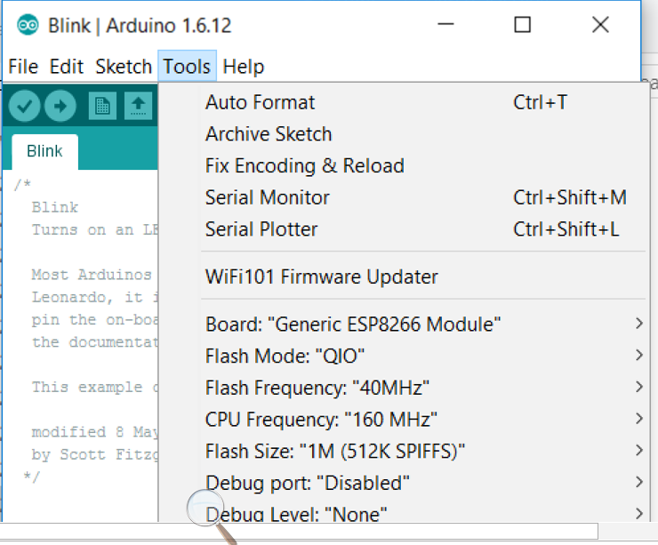

Crap... Even with the FTDi I receive an error
Uploading 416064 bytes from C:\Users\Remco\AppData\Local\Temp\arduino_build_539286/ESPEasy.ino.bin to flash at 0x00000000
................................................................................ [ 19% ]
.......................Er is een fout opgetreden bij het uploaden van de schets
I have tried many settings, but all the time the same error...
How the h*ll did you upload the ESPeasy firmware... :roll:

what settings did you use in the Arduino ide to compile and upload
and whats the size if your esp's flash ?

How can I check the size of the h801's flash?
I will make a screenshot this evening...

Reley wrote:How can I check the size of the h801's flash?
My settings are the same as the post from ledfreak3d except that my Flash Mode is "DIO" - no idea why though, but it works! My baud rate is 115200, not had any problems with any of my three H801s ...
My H801 flash looks to be a 25Q80 - I think all mine are the same so these settings should be ok for you too.

See attachment
I have tried allmost all flash sizes... none is working.
I even tried to upload a small sketch to determine the size, but that also does not work...
I have connected 4 wires to my ftdi, (3,3 gnd tx/rx) and shorted J3 on the 801..
Tried with the same settings, no go. 115200 baud is not working as well. It needs 9600....

Reley wrote:See attachment
That's strange, I have had no issues at all. A couple of points to check - don't feed the H801 off the FTDI as there may not be enough current to reliably flash. My H801 header has TX and RX swapped - so you need to join TX to TX and RX to RX (and not swapped as you'd expect). You've probably already found this though!
Tried everything... but with an external power supply he won't upload at all. He can't connect.

Reley wrote:Tried everything... but with an external power supply he won't upload at all. He can't connect.
Ok, I've not read your previous posts so apologies if you've already tried:-
1) flash original firmware using esptool
2) flash ESPEasy using esptool
3) a different USB --> serial unit
do you get the same errors?

With external power and ground connected it gives another error:
warning: espcomm_sync failed
error: espcomm_open failed
error: espcomm_upload_mem failed
[/s]
Working!
Don't know how, but its working now!
Now trying to create some nice hardware in domoticz...
