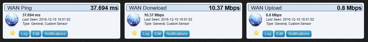

hi guys, today i change my router from the tp-link to fritzbox.
and without take any change on the rpi2 this is my new result with the test. :shock: :shock: :shock: (i have a line with 10 dw and 1 up, in italy we are very poor with the lan structure !!!! hihihihi)
i think that the old router/modem/access point don't work very good as the new.
now the router work very good. bye bye.
