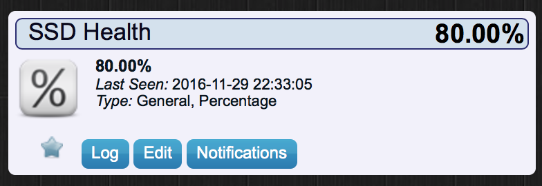

If setup correctly, domoticz will receive your results from smartmontools daily:
Screen Shot 2016-11-29 at 22.51.31.png (67.26 KiB) Viewed 2041 times
And you can do 'useful' stuff with it ;)
