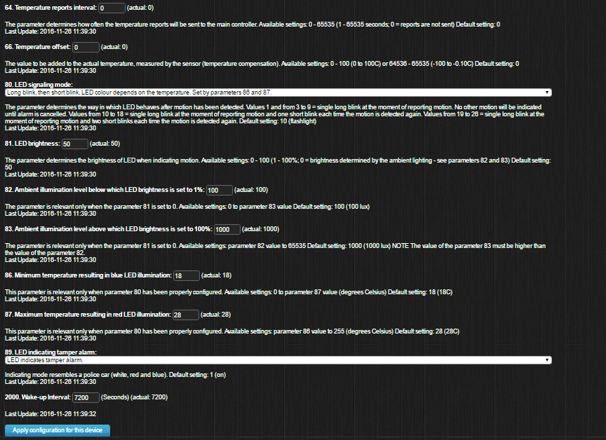

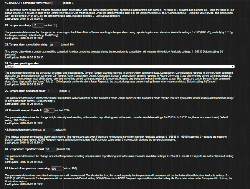

ive tried to do like you, wich means that i tried to change the FGMS configfile but i dont get the sensor to work. ive also made changes in the manufacturing file. Look at the attached file.
Do you have any ideas? Wouldnt the sensor appear as an motion sensor?

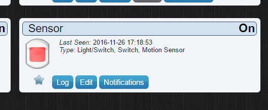

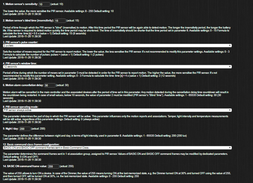

Hi, i still doesnt get it to work..... hmmm. I attached 3 copys, maybe some of you can see that something is really wrong, hopefully
3pictures / 6 pictures

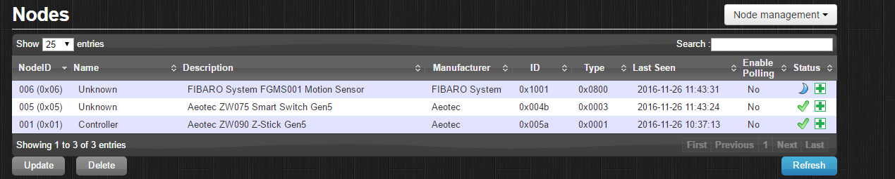

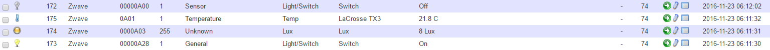

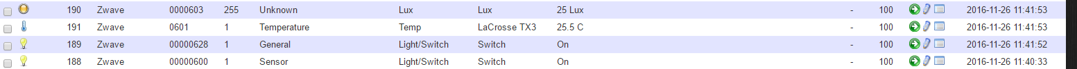

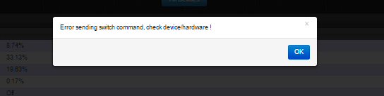

Sorry, the proble is, when i press the switch this attached copy appear
- 7.PNG (7.47 KiB) Viewed 6483 times
- StanHD
- Posts: 347
- Joined: Friday 12 July 2013 16:09
- Target OS: Windows
- Location: East Sussex, UK
Re: Config file for Fibaro FGMS001 zwave+ version
That message is by design. You can't turn a PIR on/off with a switch. Is the PIR not triggering the switch as expected when motion is sensed? Your settings seem ok. Note that you have the Wake-up set to 2 hours (7200), so any changes could take up to this interval to update. (Unless you Wake-up manualy)
