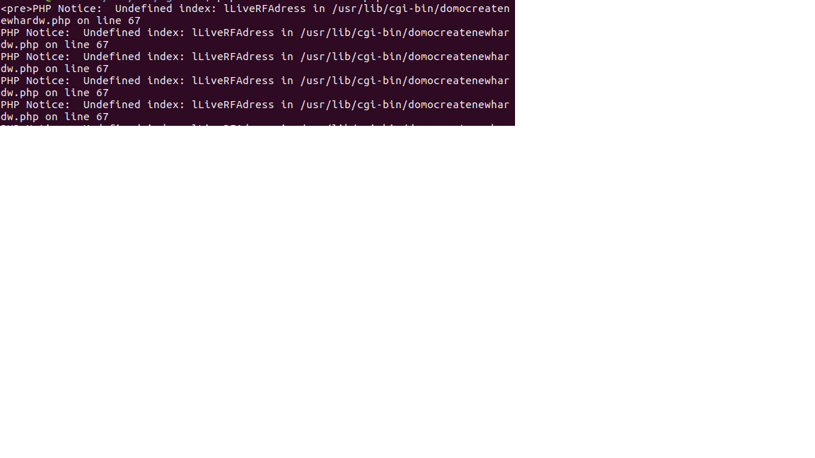

Nothing... i didn't work...
I have a question... I'm launching the script from my browser chrome on my PC and not directly from raspberry, is it ok?
domocreatenewhardwx.php_results.txt
(67.48 KiB) Downloaded 230 times

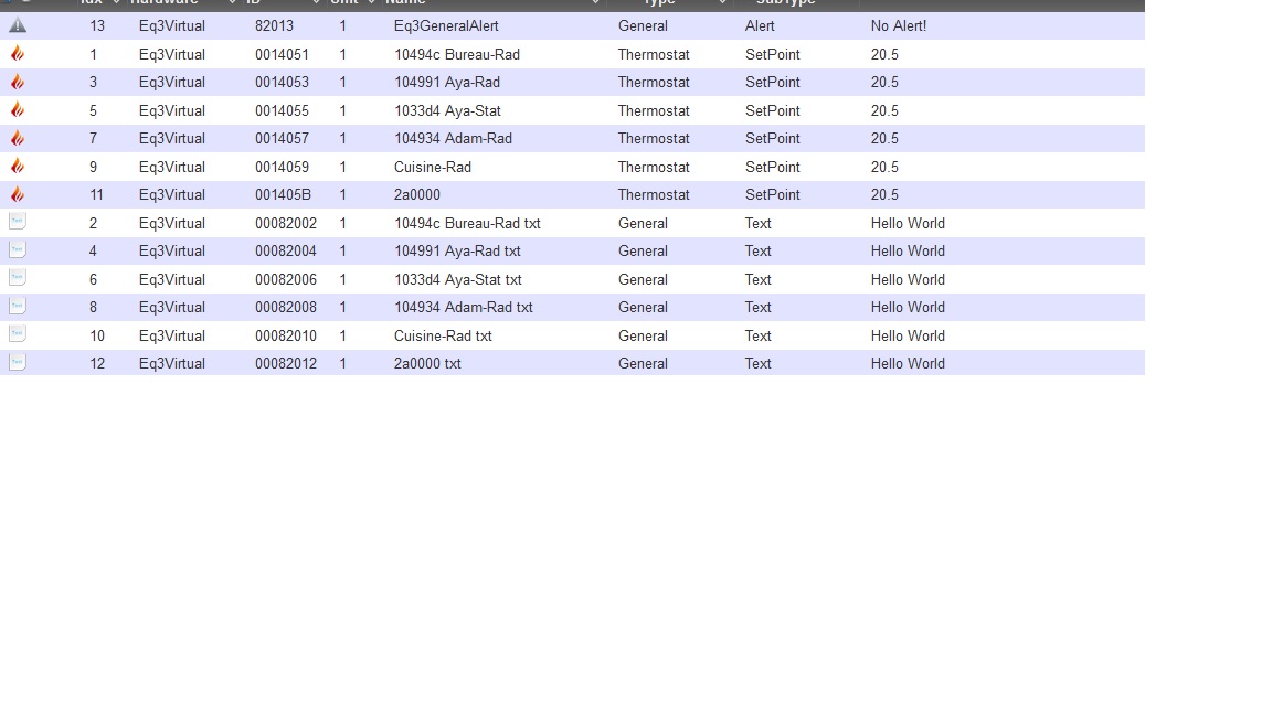

Hello
Great job guys
I have a small problem with the php script :
He is able to see my devices but not to grap the details .
The settem is at 21° but he is saying 20.5
any ideas ?
I have this 2 printscreens

Sorry for this late response, but I did not receive a notification about your question. In the second screenshot it shows strange names "Cuisine-Rad" en "2a0000". Did you manipulate this names yourself> They do not match the syntax the php scripts expects. When devices are created with a syntax like "10494c Bureau-Rad". The first 6 position are the rf-address of the valve/thermostat, followed by the name you in the eq3-max setup.
My advice is to remove the devices (also the matching text devices) that do not match the syntax. After this check to see if the remaining thermostats devices can be operated by Domoticz. If this is the case, try to recreate the missing thermostats with the script "domocreatenewhardw.php".
Hope this helps.

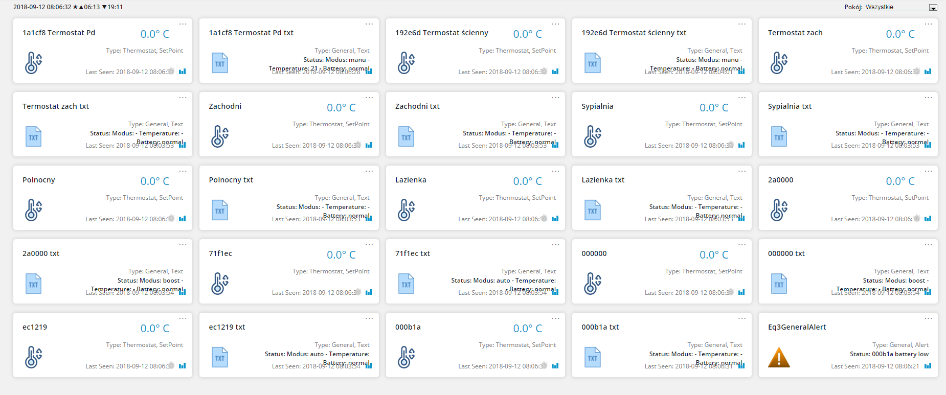

How to use this scripts with attached wall thermostats ? When I connect them and want to create new devices I have a lot of strange devices (thermostat setpoints and txt).
without_wall_thermostats.txt
(5.5 KiB) Downloaded 141 times
with_wall_thermostats.txt
(7.73 KiB) Downloaded 159 times

Please help!
I have new radiator thermostats and wall thermostat in one room
Don't work:(
Could names of rooms / units do this issue?

http://192.168.0.109:8084/json.htm?type=devices&filter=utility&used=true
   "ActTime" : 1536732207,
   "AstrTwilightEnd" : "21:20",
   "AstrTwilightStart" : "04:05",
   "CivTwilightEnd" : "19:48",
   "CivTwilightStart" : "05:37",
   "DayLength" : "12:58",
   "NautTwilightEnd" : "20:32",
   "NautTwilightStart" : "04:53",
   "ServerTime" : "2018-09-12 08:03:27",
   "SunAtSouth" : "12:05",
   "Sunrise" : "06:13",
   "Sunset" : "19:11",
   "app_version" : "4.9700",
   "status" : "OK",
   "title" : "Devices"
http://192.168.0.109:8084/json.htm?type=hardware
   "result" : [
         "Address" : "",
         "DataTimeout" : 0,
         "Enabled" : "false",
         "Extra" : "",
         "Mode1" : 0,
         "Mode2" : 0,
         "Mode3" : 0,
         "Mode4" : 0,
         "Mode5" : 0,
         "Mode6" : 0,
         "Name" : "Pogoda Rewa",
         "Password" : "pws:IGDYNIA44",
         "Port" : 0,
         "SerialPort" : "",
         "Type" : 14,
         "Username" : "2cc5f6ab120db6ee",
         "idx" : "2"
         "Address" : "",
         "DataTimeout" : 0,
         "Enabled" : "true",
         "Extra" : "",
         "Mode1" : 0,
         "Mode2" : 0,
         "Mode3" : 0,
         "Mode4" : 0,
         "Mode5" : 0,
         "Mode6" : 0,
         "Name" : "Pogoda Redłowo",
         "Port" : 0,
         "SerialPort" : "",
         "Type" : 14,
         "idx" : "3"
         "Address" : "",
         "DataTimeout" : 0,
         "Enabled" : "true",
         "Extra" : "",
         "Mode1" : 0,
         "Mode2" : 0,
         "Mode3" : 0,
         "Mode4" : 0,
         "Mode5" : 0,
         "Mode6" : 0,
         "Name" : "Ogrzewanie",
         "Password" : "",
         "Port" : 0,
         "SerialPort" : "",
         "Type" : 15,
         "Username" : "",
         "idx" : "4"
         "Address" : "",
         "DataTimeout" : 0,
         "Enabled" : "true",
         "Extra" : "",
         "Mode1" : 0,
         "Mode2" : 0,
         "Mode3" : 0,
         "Mode4" : 0,
         "Mode5" : 0,
         "Mode6" : 0,
         "Name" : "Kamera",
         "Password" : "",
         "Port" : 0,
         "SerialPort" : "",
         "Type" : 15,
         "Username" : "",
         "idx" : "6"
         "Address" : "",
         "DataTimeout" : 0,
         "Enabled" : "true",
         "Extra" : "",
         "Mode1" : 0,
         "Mode2" : 0,
         "Mode3" : 0,
         "Mode4" : 0,
         "Mode5" : 0,
         "Mode6" : 0,
         "Name" : "Wentylacja",
         "Password" : "",
         "Port" : 0,
         "SerialPort" : "",
         "Type" : 15,
         "Username" : "",
         "idx" : "7"
         "Address" : "",
         "DataTimeout" : 0,
         "Extra" : "",
         "Mode1" : 0,
         "Mode2" : 10000,
         "Mode3" : 0,
         "Mode4" : 0,
         "Mode5" : 0,
         "Mode6" : 0,
         "Name" : "PING",
         "Password" : "",
         "Port" : 0,
         "SerialPort" : "",
         "Type" : 51,
         "Username" : "",
         "idx" : "8"
   "status" : "OK",
   "title" : "Hardware"
http://192.168.0.109:8084/json.htm?type=command¶m=addhardware&htype=15&port=1&name=Eq3Virtual&enabled=true
   "idx" : "9",
   "status" : "OK",
   "title" : "AddHardware"
Array
    [idx] => 9
    [status] => OK
    [title] => AddHardware
   "result" : [
         "Address" : "",
         "DataTimeout" : 0,
         "Extra" : "",
         "Mode1" : 0,
         "Mode2" : 0,
         "Mode3" : 0,
         "Mode4" : 0,
         "Mode5" : 0,
         "Mode6" : 0,
         "Port" : 0,
         "SerialPort" : "",
         "Type" : 14,
         "idx" : "2"
         "Address" : "",
         "DataTimeout" : 0,
         "Enabled" : "true",
         "Extra" : "",
         "Mode1" : 0,
         "Mode2" : 0,
         "Mode3" : 0,
         "Mode4" : 0,
         "Mode5" : 0,
         "Mode6" : 0,
         "Port" : 0,
         "SerialPort" : "",
         "Type" : 14,
         "idx" : "3"
         "Address" : "",
         "DataTimeout" : 0,
         "Enabled" : "true",
         "Extra" : "",
         "Mode1" : 0,
         "Mode2" : 0,
         "Mode3" : 0,
         "Mode4" : 0,
         "Mode5" : 0,
         "Mode6" : 0,
         "Password" : "",
         "Port" : 0,
         "SerialPort" : "",
         "Type" : 15,
         "Username" : "",
         "idx" : "4"
         "Address" : "",
         "DataTimeout" : 0,
         "Enabled" : "true",
         "Extra" : "",
         "Mode1" : 0,
         "Mode2" : 0,
         "Mode3" : 0,
         "Mode4" : 0,
         "Mode5" : 0,
         "Mode6" : 0,
         "Name" : "Kamera",
         "Password" : "",
         "Port" : 0,
         "SerialPort" : "",
         "Type" : 15,
         "Username" : "",
         "idx" : "6"
         "Address" : "",
         "DataTimeout" : 0,
         "Enabled" : "true",
         "Extra" : "",
         "Mode1" : 0,
         "Mode2" : 0,
         "Mode3" : 0,
         "Mode4" : 0,
         "Mode5" : 0,
         "Mode6" : 0,
         "Password" : "",
         "Port" : 0,
         "SerialPort" : "",
         "Type" : 15,
         "Username" : "",
         "idx" : "7"
         "Address" : "",
         "DataTimeout" : 0,
         "Extra" : "",
         "Mode1" : 0,
         "Mode2" : 10000,
         "Mode3" : 0,
         "Mode4" : 0,
         "Mode5" : 0,
         "Mode6" : 0,
         "Name" : "PING",
         "Password" : "",
         "Port" : 0,
         "SerialPort" : "",
         "Type" : 51,
         "Username" : "",
         "idx" : "8"
         "Address" : "",
         "DataTimeout" : 0,
         "Enabled" : "true",
         "Extra" : "",
         "Mode1" : 0,
         "Mode2" : 0,
         "Mode3" : 0,
         "Mode4" : 0,
         "Mode5" : 0,
         "Mode6" : 0,
         "Name" : "Eq3Virtual",
         "Password" : "",
         "Port" : 1,
         "SerialPort" : "1",
         "Type" : 15,
         "Username" : "",
         "idx" : "9"
   "status" : "OK",
http://192.168.0.109:8084/json.htm?type=createvirtualsensor&idx=9&sensorname=1a1cf8+Termostat+Pd&sensortype=8
   "idx" : "23",
   "status" : "OK",
   "title" : "CreateVirtualSensor"
Array
    [idx] => 23
    [status] => OK
    [title] => CreateVirtualSensor
http://192.168.0.109:8084/json.htm?type=createvirtualsensor&idx=9&sensorname=1a1cf8+Termostat+Pd+txt&sensortype=5
   "idx" : "24",
   "status" : "OK",
Array
    [idx] => 24
    [status] => OK
http://192.168.0.109:8084/json.htm?type=createvirtualsensor&idx=9&sensorname=192e6d+Termostat+%C5%9Bcienny&sensortype=8
   "idx" : "25",
   "status" : "OK",
Array
    [idx] => 25
    [status] => OK
http://192.168.0.109:8084/json.htm?type=createvirtualsensor&idx=9&sensorname=192e6d+Termostat+%C5%9Bcienny+txt&sensortype=5
   "idx" : "26",
   "status" : "OK",
Array
    [idx] => 26
    [status] => OK
http://192.168.0.109:8084/json.htm?type=createvirtualsensor&idx=9&sensorname=+Termostat+zach&sensortype=8
   "idx" : "27",
   "status" : "OK",
Array
    [idx] => 27
    [status] => OK
http://192.168.0.109:8084/json.htm?type=createvirtualsensor&idx=9&sensorname=+Termostat+zach+txt&sensortype=5
   "idx" : "28",
   "status" : "OK",
Array
    [idx] => 28
    [status] => OK
http://192.168.0.109:8084/json.htm?type=createvirtualsensor&idx=9&sensorname=+Zachodni&sensortype=8
   "idx" : "29",
   "status" : "OK",
Array
    [idx] => 29
    [status] => OK
http://192.168.0.109:8084/json.htm?type=createvirtualsensor&idx=9&sensorname=+Zachodni+txt&sensortype=5
   "idx" : "30",
   "status" : "OK",
Array
    [idx] => 30
    [status] => OK
http://192.168.0.109:8084/json.htm?type=createvirtualsensor&idx=9&sensorname=+Sypialnia&sensortype=8
   "idx" : "31",
   "status" : "OK",
Array
    [idx] => 31
    [status] => OK
http://192.168.0.109:8084/json.htm?type=createvirtualsensor&idx=9&sensorname=+Sypialnia+txt&sensortype=5
   "idx" : "32",
   "status" : "OK",
Array
    [idx] => 32
    [status] => OK
http://192.168.0.109:8084/json.htm?type=createvirtualsensor&idx=9&sensorname=+Polnocny&sensortype=8
   "idx" : "33",
   "status" : "OK",
Array
    [idx] => 33
    [status] => OK
http://192.168.0.109:8084/json.htm?type=createvirtualsensor&idx=9&sensorname=+Polnocny+txt&sensortype=5
   "idx" : "34",
   "status" : "OK",
Array
    [idx] => 34
    [status] => OK
http://192.168.0.109:8084/json.htm?type=createvirtualsensor&idx=9&sensorname=+Lazienka&sensortype=8
   "idx" : "35",
   "status" : "OK",
Array
    [idx] => 35
    [status] => OK
http://192.168.0.109:8084/json.htm?type=createvirtualsensor&idx=9&sensorname=+Lazienka+txt&sensortype=5
   "idx" : "36",
   "status" : "OK",
Array
    [idx] => 36
    [status] => OK
http://192.168.0.109:8084/json.htm?type=createvirtualsensor&idx=9&sensorname=2a0000+&sensortype=8
   "idx" : "37",
   "status" : "OK",
Array
    [idx] => 37
    [status] => OK
http://192.168.0.109:8084/json.htm?type=createvirtualsensor&idx=9&sensorname=2a0000++txt&sensortype=5
   "idx" : "38",
   "status" : "OK",
Array
    [idx] => 38
    [status] => OK
http://192.168.0.109:8084/json.htm?type=createvirtualsensor&idx=9&sensorname=71f1ec+&sensortype=8
   "idx" : "39",
   "status" : "OK",
Array
    [idx] => 39
    [status] => OK
http://192.168.0.109:8084/json.htm?type=createvirtualsensor&idx=9&sensorname=71f1ec++txt&sensortype=5
   "idx" : "40",
   "status" : "OK",
Array
    [idx] => 40
    [status] => OK
http://192.168.0.109:8084/json.htm?type=createvirtualsensor&idx=9&sensorname=000000+&sensortype=8
   "idx" : "41",
   "status" : "OK",
Array
    [idx] => 41
    [status] => OK
http://192.168.0.109:8084/json.htm?type=createvirtualsensor&idx=9&sensorname=000000++txt&sensortype=5
   "idx" : "42",
   "status" : "OK",
Array
    [idx] => 42
    [status] => OK
http://192.168.0.109:8084/json.htm?type=createvirtualsensor&idx=9&sensorname=ec1219+&sensortype=8
   "idx" : "43",
   "status" : "OK",
Array
    [idx] => 43
    [status] => OK
http://192.168.0.109:8084/json.htm?type=createvirtualsensor&idx=9&sensorname=ec1219++txt&sensortype=5
   "idx" : "44",
   "status" : "OK",
Array
    [idx] => 44
    [status] => OK
http://192.168.0.109:8084/json.htm?type=createvirtualsensor&idx=9&sensorname=000b1a+&sensortype=8
2018-09-12 08_06_39-Domoticz – Opera.png (116.07 KiB) Viewed 6181 times
adresses miss.
Can I add adresses manually and delete weird items?
