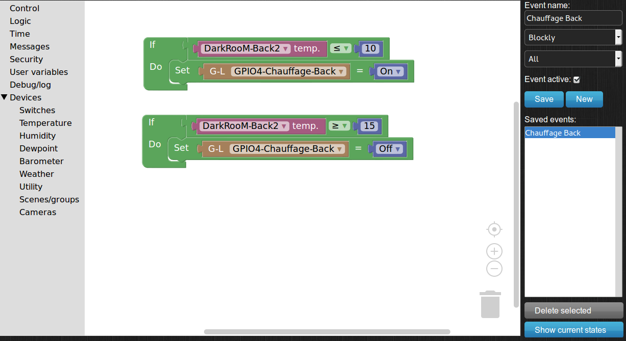

Thanks for your answer! If I understand well I have to use Blockly in event menu in Domoticz and create 2 blocks for define the lowest temperature and the action and the highest temperature and the other action?

something like this?

Greats!! Thanks to you! It's working!
