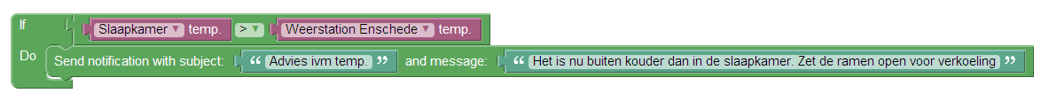

I created an event to check if my bedroom-temperature is bigger than the outside-temperature (so it's better to open the windows for some cooling down), but the event is spamming me every minute with the same advice (to test, I used < instead of >).
I changed < into > (so the event doesn't apply anymore), but it is still sending me messages. Then I tried do deactivate the rule, but the messages are still coming in. What to do?

I dont know if the weather underground temperatures work yet. The second one now probably evaluates to 0, making this true everytime the slaapkamer temp comes in. Buy a real one for outside in the mean time, I can confirm they work. It's probably not such a good idea to trigger events based on an external source anyway, what if they send 0 temp by accident all day?

This also doens't work with my own sensors... I have the same problem with sensors I bought and installed. I also tried to swithc < to > and vice versa, but it keeps spamming me...Dynamic wrote:I created an event to check if my bedroom-temperature is bigger than the outside-temperature (so it's better to open the windows for some cooling down), but the event is spamming me every minute with the same advice (to test, I used < instead of >).

I tested this as well with my own sensors and I too am receiving emails by the minute. I guess that's how the notification system works in blocky?fl1p wrote:This also doens't work with my own sensors... I have the same problem with sensors I bought and installed. I also tried to swithc < to > and vice versa, but it keeps spamming me...Dynamic wrote:I created an event to check if my bedroom-temperature is bigger than the outside-temperature (so it's better to open the windows for some cooling down), but the event is spamming me every minute with the same advice (to test, I used < instead of >).

If you just specify "send me a notification when temp > X" you will get a notification each time the device reports in. That is literally what you get with such a rule; couple it with another device like "if temp >x and fan = off set fan = on and send notification". Then the rule will trigger once because the fan is off, second time the fan is on.
I really want to keep blockly simple in the sense that it does what it says/you say. Use lua if you only want the notification once, put in a time constraint like my garage door example. I don't want to put hidden clauses in blockly that say "well only send this notification once" without it being very intuitive what is happening. When would be the next time to send one? Blockly = keep it simple, stupid, lua = advanced.
