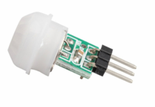

I am having a hell of a time trying to calibrate these pir sensors the cheap ones trying from ali express here
https://www.aliexpress.com/item/NEW-PIR ... 677b5e8301
I have tried to search through the forums but it is lacking a bit of information
i have found this which gives the pinout. https://saturn.ffzg.hr/rot13/index.cgi/ ... 12-0-25685
I am having a ton of false positives no matter which way I turn it. If I turn them one way it calms the fp's but then turns into false negatives which is equally as bad if I turn them the other way tons of FP
I have tried 3 of them so I might be in my settings of domoticz/ esp or on the pir itself any suggestions are appreciated
I have it hooked up to espeasy here are the settings
GPIO 0
pulled up (checked)
inversed (checked)
switch type (switch)
switch button type (normal switch)
send boot data (unchecked)
send data (checked
I have tried both pull up and inversed both ways doesn't make a difference
in domoticz itself
standard dummy switch
switch type = motion sensor
it communicates fine with domoticz and i see it turn on and off so I would assume there is nothing wrong there.
ANY SUGGESTIONS would be great

mm There was something withe voltage icw the pir..
What is power u use..?
What software u use?
espeasy?
espeasy?

I have never been able to get a stable PIR node with ESP, most of the PIRs need 4-5v to function properly.
There is a workaround for some of the PIR models out there, you can cut some copper traces on the sensor to get it working with 3.3v, check out the ESPEasy forum.
If you want to make more DIY nodes you could look into MySensors (wireless arduino nodes), i have 5 nodes with RGB LED strips, 3 PIR, 2 "clappers" and 2 nodes with LCD/OLED display running stable as a rock.

I am currently using 3.55 volts for the sensor as it said it could accept a range of 3-5v. I don’t want to go higher as I made a custom circuit board that powers all accessories and the esp itself from the same psu. even though I am pretty sure I have an esp on 5v and it was fine by accident.
I could maybe try it on 5 volt just temp to see if it alleviates any issue on a separate line.
@toreandre yes you are right there is a workaround as hotwiring a pin from power to high pin on jumper or to go past the voltage regulator. I have tried both and have powered it directly with 3.55 v from the standard power pin and it does power up and "works"
I have also tried setting a pull up resistor in the software and disabling that then putting an actually 10k pull up in between and same thing
If you don't change the pir to work on 3,3 V http://www.instructables.com/id/Convert ... r-ESP8266/
it needs 5V otherwise you get lots off false positives.

Yes, but the arduino supplys 5v, not 3.3v as the ESP does and the 3.3v is a bit too weak for many of the PIR sensors (and other DIY modules).borgkitty wrote:I can certainly look into this however looking at the website from mysensors they use the same exact PIRtoreandre wrote: If you want to make more DIY nodes you could look into MySensors (wireless arduino nodes), i have 5 nodes with RGB LED strips, 3 PIR, 2 "clappers" and 2 nodes with LCD/OLED display running stable as a rock.

so i changed it to 5 v no difference. I changed it to 12 v no difference. I completely disconnected the esp entirely and measured pin voltage manually no difference. I have tried shielding it with tin foil grounded as suggested in some other posts no difference.
Any other suggestions?

I wasted far too much time on those sensors - if you hunt around using google you will find that they usually give false positives with esp8266
You can power them easily with 3.3v by feeding +3v to one of the jumper pins - just meter the pin that connects to the regulator output.
However, like I said its very hard to get those devices stable near an esp8266.
I'm now using these devices:
http://www.ebay.co.uk/itm/Mini-IR-Infra ... SwZVlXrsXI
These don't seem to false trigger with the esp8266 and run find on 3.3v.
They don't have an easy way to adjust sensitivity though, I ended up putting black tape to partially cover the one outside my front door in order to stop it reacting to cars and people passing 30 feet away!

I did not read the complete post but I had false positives to. Costed me some time to figure out so I think some more people will like this reply.
After soldering a ceramic capacitor of 180 or 220 nF over pin 12 and 13 problem was solved.
As well the small cheap PIR doesn’t have any problem work out of the box, only you cannot adjust range and time.
- 2018-02-21 10_37_34-Wholesale Product Snapshot Product name is 5Pcs Hot Sale Mini IR Infrared Pyroel.png (47.47 KiB) Viewed 19448 times
- 2018-02-21 10_27_18-IMG_20180128_183009.jpg - Windows Photo Viewer.png (136.83 KiB) Viewed 19448 times

I solved the issue by adding a 47uF capacitor between the + pin and ground pin.
It seems that the HC-SR505 Infra Red sensor is sensitive to the noise on the power supply.
André
