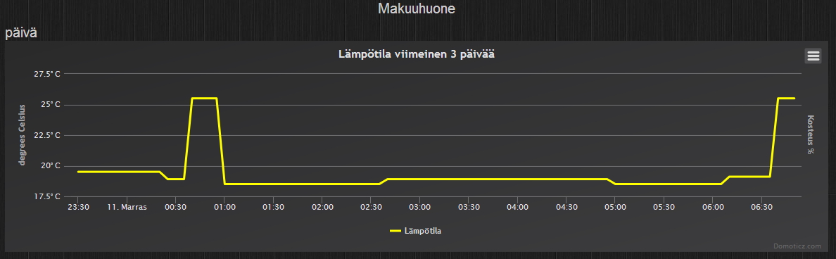

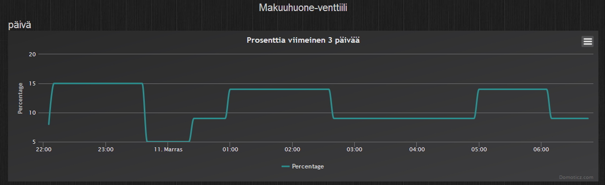

Hold your horses! It just occurred to me that it will report 0 degrees whenever the valve doesn't communicate its temperature. That is probably not what you want. So I changed the code again. Plus I uncommented it already, since your explanation convinced me that more people might be interested. You can always choose not to add the sensor to the list of used devices.
You was right. During the night I have got couple times temperature of 25.5 decrees from room without WMT. I checked with maxtest.lua that received current radiator temperature is really 0 decrees. So thermostat valve looses it's current temperature. There hasn't been any change in setpoint during that time so could it be reason for strange temperature readings?
Bedroom setpoint
Bedroom setpoint

Bedroom valve movement

I changed setpoint and after that reported temperature returned from 25.5 decrees to value it should be.

Teatech wrote:I changed setpoint and after that reported temperature returned from 25.5 decrees to value it should be.
Valves don't communicate their temperature when they have not been active for a while, and since a variable always needs to have a value, the script gives it a value of zero in such cases.
In another part of the script, values below 5 degrees (so also 0 degrees) are converted to their value + 25.5, which explains your readings. This is done because there is an "interesting" phenomenon in the communication with the MAX! devices, where temperatures above 25.5 degrees are reported as their value minus 25.5. Has to do with only two hex digits being used for temp.
Anyway, I have made a small change to prevent this from happening again. You basically only have to change "if temp ~= 0 then" into "if temp ~= 25.5 then"

Re: ELV Max! Heating control system
Post by Teatech »
mvzut wrote: By the way, there's a little trick you could use which will make it easier to find out which newly created Domoticz device belongs to which MAX! module: if you run the maxtest.lua script from the Wiki, it will show an address for each module. In the devices page of Domoticz, al new "Unknown" devices use this address as their ID. This should make it easy to find which MAX! module it belongs to.
That is just the way I used to identify devices, very easy. Of cource it would be easyer to start using script if everyting happens automatically. But it's quite easy already.
I have also received those 10 sec run warnings. But as I mentioned earlier that happens only few times a day so it doesn't really matter.
And because I only have 3 devices that communicates with cube/domoticz I can't be sure what part uses too much time while script is running. I have noticed that in my case using MAX! software directly all happens quite fast. Problem might be in communication between cube and devices in case that signal strength is poor or disturb. That may also explain why it happend only irregulary; there is some other RF communication at that channel at time of MAX! tryes to communicate with own devices. Because RF communication takes longer causes delay in http communication also.
It is very common that devices that uses RF communication like temperature/humidity meters that may communicate only one way (saves power) tryes to send data irregulary to avoid conflicts with other RF devices. It helps to get message trough even sometimes.
It would be nice to have sniffer to check radio communication. I also use 433MHz RFLink and I got lots of devices that I really don't know what they are. But I'm sure they are not mine.
