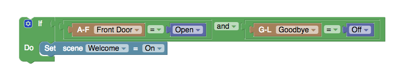

I have a door contact and a virtual switch within Domoticz. I am trying to create an event which starts a scene if the door opens while the virtual switch is off and does nothing if the door opens but the virtual switch is on.
So far I have tried using Blockly but haven't had any success so far.
I have tried:
Screen Shot 2016-11-10 at 20.31.41.png (23.72 KiB) Viewed 1357 times
I have also tried adding 'or else' if Door=Open + Goodbye(Virtual)=On
and left the 'Do' block empty.
At the moment I am looking for an implementation in Blockly - I have never used Lua before and would like a quick solution before I embark on the adventure of learning and writing a script in Lua.
If anyone has any suggestions it would be greatly appreciated.
Many thanks,
Fred.

Use a simple if block instead of a if/else block

it's looks that some things are not implement in blockley
The thermostat is not working also...
perhaps you can write?

Thanks for your replies;
I have tried a single if block as in the above image, can it be made simpler?

Jzjr wrote:Thanks for your replies;
Yes, as @Egregius suggests, use the "If" block without the blue symbol.

Thanks for your replies, using the 'If' block without the symbol worked. I wasn't aware there was any difference unless using an 'else' statement.
