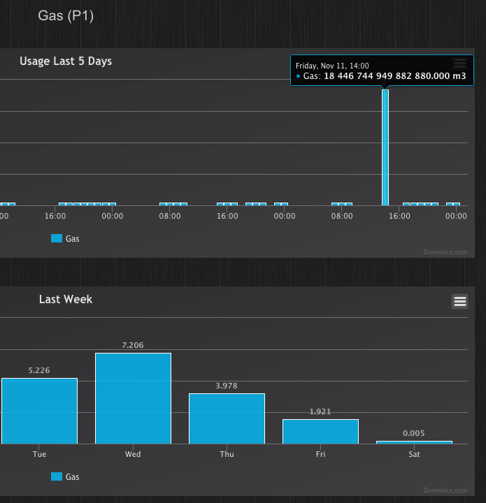

Tried with a new install of Firefox and no joy. Interesting part is that I edited the database and the 'Friday' in 'Last Week' graph is corrected, but the entry on the actual day/hour is still showing a very large number
Screen Shot 2016-11-12 at 12.21.55.png (98.17 KiB) Viewed 3884 times
stlaha2007
Posts: 370
Joined: Monday 05 October 2015 10:16
Re: Delete data point function removed?
Post by stlaha2007 »
please remember those weird values have an origin of misbehaving sensor reading. Mostly feeding an value thats lower then the previous.
There are numerious posts about this... Most of the time it will correct itself, so be patient for a day. The logic behind has some filters already...
Still they do show sometimes, dont worry if your total for the day is correct.
rjblake
Posts: 142
Joined: Friday 21 October 2016 9:25
Post by rjblake »
stlaha2007 wrote:please remember those weird values have an origin of misbehaving sensor reading. Mostly feeding an value thats lower then the previous.
Actually mine are down to having the electric and gas meters replaced. As result, new meters are installed with initial meter readings of 0.000. I'm guessing there is no easy way to reset/amend the values, as it is not likely that meters are replaced on a regular basis; if at all. However, it may make sense to better allow editing of values and starting points exactly for these reasons. Mine would never have corrected itself. In the end, I made a backup of the database, deleted the hardware and recreated them. Not really a big deal, as I only had around 2 weeks of data history. I did consider manually updating a lot of the records in the database, but in the end it was quicker to simple start again. :)
stlaha2007
Posts: 370
Some meters have adjustment. In your case, perhaps create dummy and replace them with your current meters. saving your history. And let the smartmeter recreate them, basicly starting over.
Test this first on a few dummymeters. As i dont know for now if you replace the newest with previous or previois with newest.

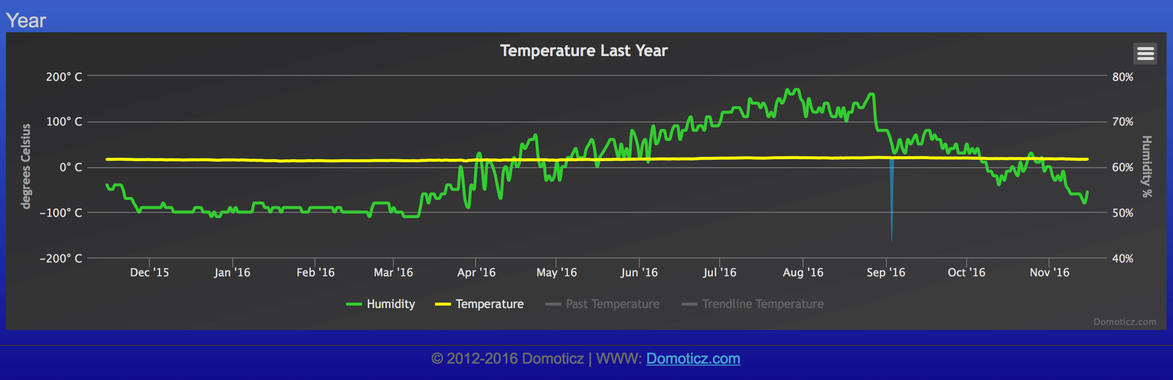

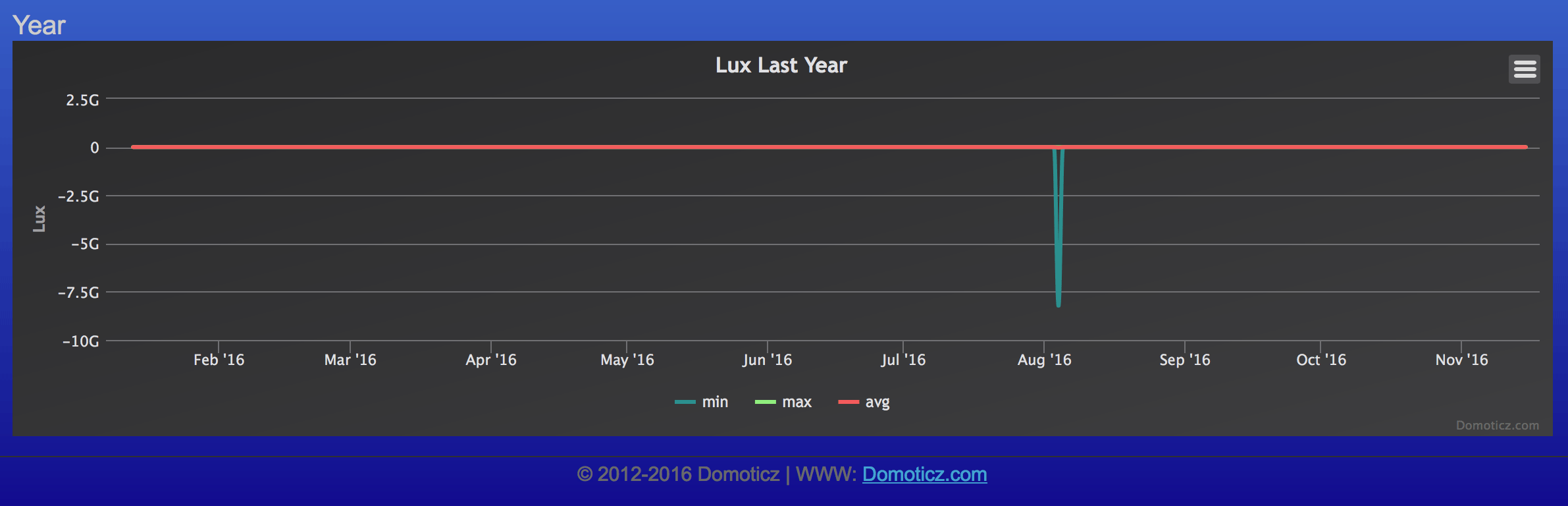

I have never been able to delete data points on Mac (safari, firefox, chrome) even zoomed in.
I wish I could though as I have some weird values that lie so far outside of the range that they make the whole graph useless.
These two examples of outlying values did not occur on the same date, on the same version of domoticz and on the same type of sensor. One is a RFXCom temp sensor and the other a z-wave motion/lux... detector. So I suspect this has to do with Domoticz itself.
stlaha2007
Posts: 370
Re: RE: Re: Delete data point function removed?
phitar wrote:I have never been able to delete data points on Mac (safari, firefox, chrome) even zoomed in.
This is something i haven't seen earlier... Its also strange you can't delete any datapoint regardless what browser...
I suggest you backup your database, delete domoticz and reinstall domoticz and upload your backup. Delete any cached data etc in your browser(s). And try again to delete those weird values.
Hope that will solve it.
