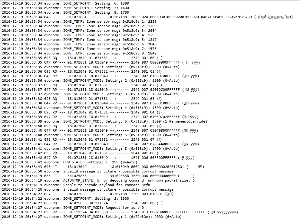

By the way, do you have any idea why my log has countless entries as follows:
2016-12-19 12:23:16.351 Error: evohome: ACTUATOR_STATE: Error decoding command, unknown packet size: 6
2016-12-19 12:23:16.351 Error: evohome: unable to decode payload for command 3ef0
All devices seem to be working ok so not sure what it's related to...

My best guess is that it's likely that the OT module is only partly implemented in Domoticz and hence the 'unknown packet size'. The code currently expects the payload (data) for the 0x3EF0 (ACTUATOR_STATE) command to be 3 ie. 0xXXXXXX and only the last XX is used (00=Off, FF=On). However, it sounds like the OT module is sending 0xXXXXXXXXXXXX. Can you also post the raw message from the line before in the evoraw.log file to give me some idea of what the contents of the payload looks like as this might help me work out what extra info it's including in this message.
Dan
Dan

Here's a snippet from the evoraw debug log after I transferred it from my Ubuntu box to a Windows box with Cyberduck:

stumbled across this post from almost two months ago. Interestingly enough it seems my HGI80 is picking up signals from a neighbouring Evohome and binds those to the first IDs
Also, the heating setup in my house concerns -two- central heating systems. no1 for the rgound floor with its own controller (non evohome), and no2 for the first and second floor (evohome controlled). I would definately be interested in the ability to mount a secondary evohome system on my ground floor and have both systems report to domoticz. As I understand from you this is not (yet) possible.
Anyway, the whole thing with the neighboring setup becomes a mess. I have oscillating measurments reported in sensors etc...
I would be interested in trying your solution?
Looking forward to your response
regards
regards

Good timing, you're in luck! I've just recently created a new branch in my Github development area https://github.com/Evsdd/domoticz called 'Multi-controller' which you're welcome to try out if you're able to compile Domoticz from source. I suggest that you create a new install area on your machine so that it doesn't mess up your current Domoticz installation, device list etc. I've successfully completed my testing of the code, but would like a few others to test it out and it will also take me a while to re-integrate this branch back into the main Domoticz repository as I made updates to some of the JavaScript to add the user interface pieces.
Here's a brief user guide for this functionality:
Please let me know how you get on.
Dan
- Add the Evohome HGI80 hardware device to Domoticz as usual.
There's a new configuration field where you should add the hex device ID for your controller. You can find this ID by holding the settings button the 15secs on the controller and a screen will appear showing the device ID.
The initial set-up and device creation will start and after 5min, if multiple Evohome controllers are detected and you haven't set your controller ID, it will write the following error to the log 'evohome:Error multiple controllers detected. Please set controller ID in hardware settings' and the HGI80 device will terminate in Domoticz.
If you've set the Device ID, everything should now work OK in Domoticz and the other Evohome system(s) shouldn't interfere with yours.
