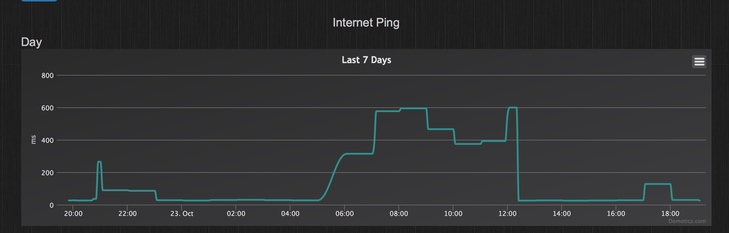

emme wrote:low ping means fast response.... so it's good
high ping means slow response... that' bad
Watch out the unit: normally it's ms-->milliseconds
What's a normal/good ping?
safi78
Posts: 204
Joined: Thursday 05 September 2013 15:39
Domoticz version: LastBeta
Re: monitor internet connection with virtual sensors
Post by safi78 »
The lower the better. Here's my graph, lowest I got was 25'ish (on cablemodem)
Screen Shot 2016-10-23 at 19.09.29.png (292.29 KiB) Viewed 3775 times
I eventually found out my problem so, the very high pings are either other stuff that's going on (downloading stuff with sabnzbd full throttle) or my connection with my cable modem and switch flappy (probably the auto-negiotation about duplex / speed etc going haywire). Still have to fix that, but TP-link doesn't offer a lot of Mac-software to manage stuff :(

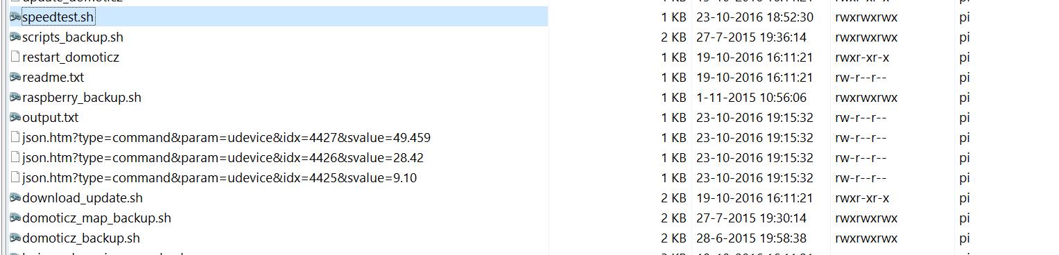

mmm
Hope this "garbage " give no trouble...
I mean the Json files
Or i there something that i do wrong ...
This going to kill my sd ...[ after a few months .]

hmm i have the same thing, even with the 'wget -q' and redirect to /dev/null etc. weird. gotto look into that.
somewhat reassuring, I think I'm using my SSD for about 2 years now with a lot of scripting, testing, trial and error, etc and it's still fine.

Try this:
curl -s -i -H "Accept: application/json" "http://$host:$port/json.htm?type=command&param=udevice&idx=$idxdl&svalue=$download"
curl -s -i -H "Accept: application/json" "http://$host:$port/json.htm?type=command&param=udevice&idx=$idxul&svalue=$upload"
curl -s -i -H "Accept: application/json" "http://$host:$port/json.htm?type=command&param=udevice&idx=$idxpng&svalue=$png"
this will not add files

do i need to replace this.. or add?
geho
Posts: 13
Joined: Thursday 08 August 2013 22:30
Post by geho »
replace it

@geho: Thanks a bundle! Added to original post.

Dear Safi,
looks working @ my crontab time.. without garbage in my sd.. [ love your great work ]
See tomorrow, how his is working

Works great without garbage
