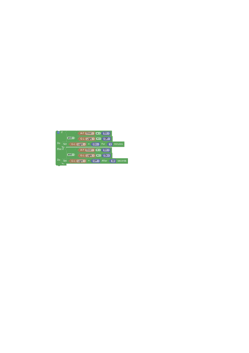

I hope someone can help me. I've got a door sensor and a Qubino relay module installed to control a lamp inside my front door. The same light is also connected to a traditional switch for manual control. Door switch is "ON" when the door is open and "OFF" when the door is closed.
I would like to have two separate events, entry and exit. If the lamp is off and the door opens, turn it on for five minutes (entry). If the lamp is on and the door opens, turn it off after two minutes (exit). Both events are very simple but I just can't get them to work together.
I guess I need a dummy switch to separate these two events somehow?

sailmich
- Posts: 245
- Joined: Wednesday 17 February 2016 22:55
- Location: Germany
Re: Blockly examples
@bonterra I tried with success what you want to do. See attachment.
Problem with that is if you changed your mind, for example you have forgotten something inside and you are open the door inside the 120 seconds, you will start the 5 minutes. At least in my opinion you need a PIR sensor inside your room to make the system running perfect.
regards
regards
- Bildschirmfoto vom 2016-11-14 16-19-41.png (23.4 KiB) Viewed 3844 times

not with my solutionsailmich wrote:Problem with that is if you changed your mind, for example you have forgotten something inside and you are open the door inside the 120 seconds, you will start the 5 minutes.
bonterra
- Posts: 6
- Joined: Wednesday 19 October 2016 13:53
Thanks, I might go for something like this.four2six wrote:I'd try virtual switches, one called 'entry', one 'exit'.

A PIR would be ideal, then it wouldn't matter if the door was opened twice during the active minutes. I'll have a look and see what I can find.sailmich wrote:@bonterra I tried with success what you want to do. See attachment.
regards
Thanks for your help, both of you!
Now I just have to figure out why I can't control the second channel of the Qubino (porch light) from the wall switch, it's wired just like the first channel (indoor light)...

@four2six, virtual switches are fantastic. I tried as you wrote in one block but it doesn't work. With three it works.
I should more often create virtual switches
regards
