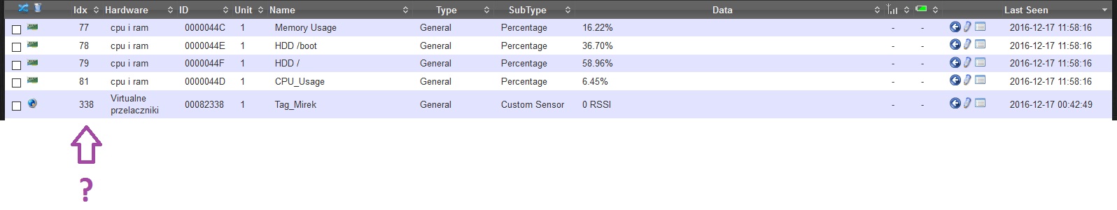

Please help with configuration:
TAG_DATA = [
["Tag_Mirek","F2:FB:9F:D4:3E:F0",30,0,336,REPEAT_MODE]
336 in my case is correct?
Any suggestions?
Error log:
2016-12-17 12:04:52,982 - root - DEBUG - Ok hci0 interface Up n running !
2016-12-17 12:04:52,983 - root - DEBUG - Connect to bluetooth device 0
2016-12-17 12:04:55,574 - root - DEBUG - Tag Tag_Mirek Detected f2:fb:9f:d4:3e:f0 - RSSI (-65,) - DATA unknown (-16,)
2016-12-17 12:04:55,628 - root - DEBUG - Tag Tag_Mirek is still there with an RSSI of -65 : update presence with RSSI
2016-12-17 12:04:55,631 - requests.packages.urllib3.connectionpool - INFO - Starting new HTTP connection (1): localhost
2016-12-17 12:04:55,655 - requests.packages.urllib3.connectionpool - DEBUG - "GET /json.htm?type=command&param=updateuservariable&idx=336&vname=Tag_Mirek&vtype=2&vvalue=-65 ('HTTP/1.1',)" 200 58
2016-12-17 12:04:55,657 - root - DEBUG - <Thread(Thread-2, started 1977799792)> -> <Response [200]>
2016-12-17 12:04:59,437 - root - DEBUG - Tag Tag_Mirek Detected f2:fb:9f:d4:3e:f0 - RSSI (-71,) - DATA unknown (-16,)
2016-12-17 12:04:59,442 - root - DEBUG - Tag Tag_Mirek is still there with an RSSI of -71 : update presence with RSSI
2016-12-17 12:04:59,444 - requests.packages.urllib3.connectionpool - INFO - Starting new HTTP connection (1): localhost
2016-12-17 12:04:59,469 - requests.packages.urllib3.connectionpool - DEBUG - "GET /json.htm?type=command&param=updateuservariable&idx=336&vname=Tag_Mirek&vtype=2&vvalue=-71 ('HTTP/1.1',)" 200 58
2016-12-17 12:04:59,472 - root - DEBUG - <Thread(Thread-3, started 1977799792)> -> <Response [200]>
Error from domoticz:
2016-12-17 12:10:35.289 Error: EventSystem: in TAG: [string "x = tonumber(uservariables['Tag_Mirek'])..."]:11: attempt to concatenate global 'x' (a nil value)
