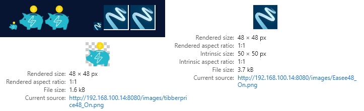

I have some of my custom icon that get two sides with white lines.
Left side is without lines and right with lines.
The information about the icons is from Inspect with the browser
Why does Domoticz add intrinsic and what does it mean?

I was using Domoticz icon generator and it creates 50x50 icons.
When I removed the extra 2 pixel-lines and upload to Domoticz and using Incognito window everything was OK

I had the same with some of my custom icons, giving me an extra white line at the right and the bottom.
The problem is that https://domoticz-icon.aurelien-loyer.fr/ creates the Domoticz icons in 50 x 50 pixel format instead of 48 x 48 pixels, as required by Domoticz. This is a bug.
And, yes, after correction you need to clear the cache. That is correct.
