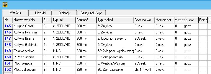

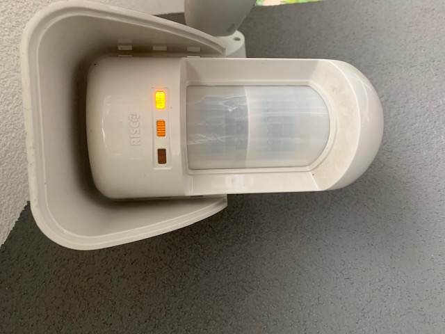

I've four external curtain (PIR sensors dedicated to detect movement around my building). I assume that such a sensors acts as ordinary PIRs. After connecting domoticz to my Satel hardware via ETHM-1 plus, I can see this devices, but they do not change status at all or domoticz can not recognize change of its status. I've checked using DLOADX app if I can observe any status change and suprisely I see it. From DLOADX point of view everything works just fine.
I would like to use this PIRs to turn on external lights during the night if movement will be detected, but this is impossible if domoticz can not recognize status change. Below I attach photo of such a sensor. Sensor model: RISCO RK315DT.
Can you somehow help me with my issue?
Irek

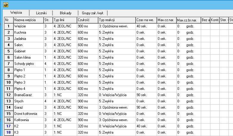

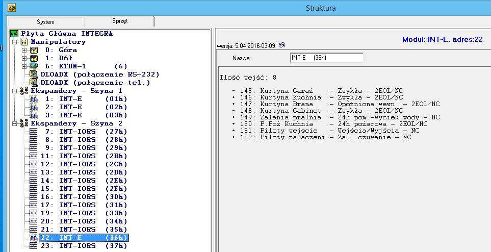

I'll try to answer some of your questions, but first I've to explain that I'm not the one who has installed whole alarmed system in my house. I was talking to the fitter (who did this) couple of weeks ago. Whole installation is about two years old and the situation is the same from the begining. The fitter has told me, that he has no idea why domoticz can not "catch" status change of those particular PIRs, because they are connected to Satel hardware (not wireless) the same way as many other PIRs in my house. All other PIRs works just fine. Below I attach print screen with some of my PIRs and the problem ones has idx: 145, 146, 147, 148. All other PIRs and reeds (kontaktrony) installed in window frames and doors works great. To answer the question related to connection method, I'll check it tomoorow, but I assume that it's the same way as many other PIRs in my house.

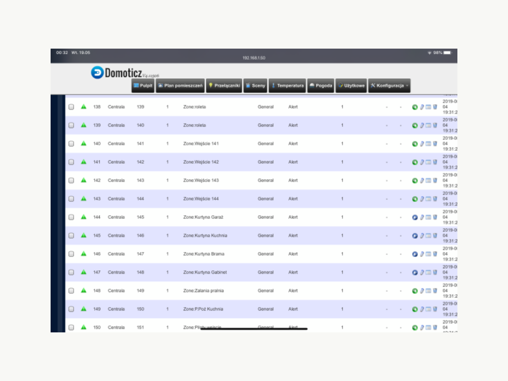

- Posts: 13
- Joined: Friday 25 January 2019 16:19
Re: Satel Integra (Security System) with ethernet module
Hi Fantom,
I've checked logs, and there is nothing form devices with idx: 145-148. All other PIRs works fine. I also know that type of line of all my PIRs is 2EOL/NC - have a look on print screens below. One last thing that bothers me is on image with hardware structure: module INT-E row nr 22. This one is different than the others where module is INT-IORS. I've no idea if it's important but all my external PIRs are connected to this module (row 22).
