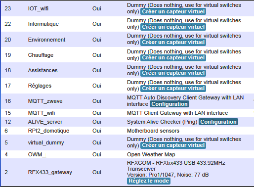

perhaps
MQTT Auto Discovery Client Gateway with LAN interface
MQTT Client Gateway with LAN interface
rpi : Raspberry Pi 2 Model B Rev 1.1 / Modele : Cortex-A7 armv7l GNU/Linux / Os Name : bullseye
Docker/Domoticz/zwave-ui/homebridge/mosquitto/wireguard

That's not a plugin, but "internal hardware", and that does not use those API calls.
And if you use the latest beta, the error should be a little bit more descriptive.
