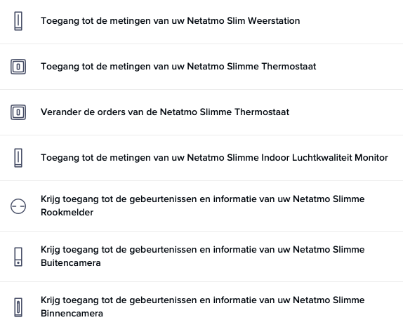

Instructions from the PR: https://github.com/domoticz/domoticz/pull/5815
step 1:
Setup an App under MyApps in the Netatmo developers portal
The Redirect_URI has to contain
Once configured correctly, the Client_ID and Client_Secret will be generated and shown.
step 2:
In the domoticz hardware setup:
This URL brings you to the My Netatmo page where you have to identify yourself and are asked for permission to grant access to certain devices and types (based on the scope provided).
After confirmation, your browser will try to redirect you to a page it cannot find so you will get an error. But the URL of that page is visible in the browser and looks like
You need to pass this SOMECODE as the password in the domoticz hardware screen.
NOTE:
At the moment, the scopes are fixed to read_station read_thermostat write_thermostat read_homecoach read_smokedetector read_presence read_camera
The <SOMECODE> you retrieved is only valid for a few minutes, so if you take too long and domoticz says (check the logs) it cannot login, retrieve a new code and be a little quicker

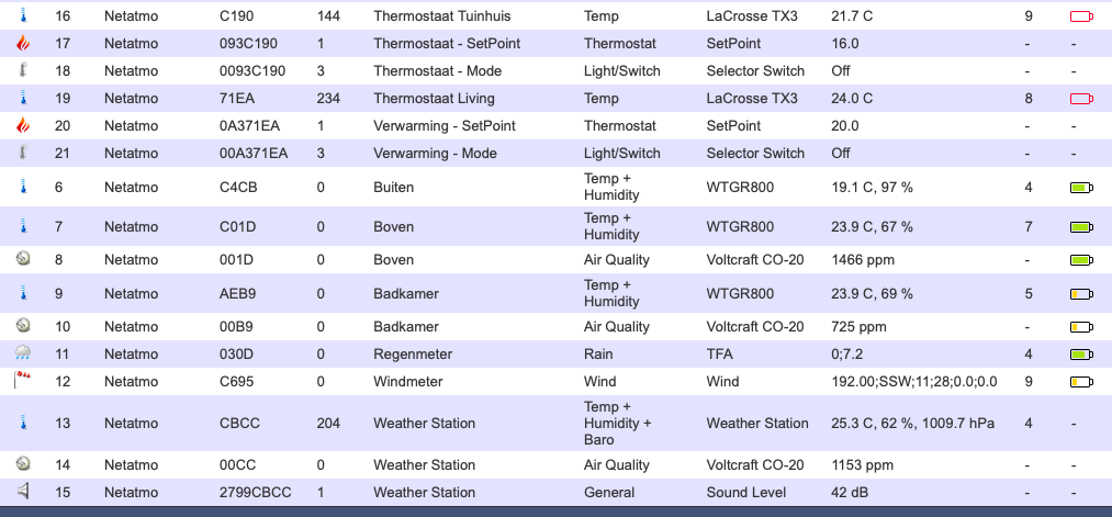

homeJLB
- Posts: 153
- Joined: Tuesday 16 October 2018 23:01
- Domoticz version: 2024.7
- Location: Belgium
Re: Netatmo authentication changes Oct 2022
I have made a new installation with docker and follow the instructions.
Now I see my 2 thermostat and the weather station, and they are updated.
But my homecoach and camera's with doorsensors and valve-thermostats and smoke-sensors are not shown?
I'm on Build 2023.2 15535
These are the only devices that show up in Domoticz I'm I doing something wrong? or do I miss something ?
when I log in to the Netatmo website I do have access to all the devices.
but the Netatmo.h uses the scope NETYPE_WEATHER_STATION = 0, NETYPE_HOMECOACH, NETYPE_ENERGY
so I suspect that the homecoach, weather station and thermostat with valves will work.
But for some reason on my setup the homecoach and the valves are not working.
