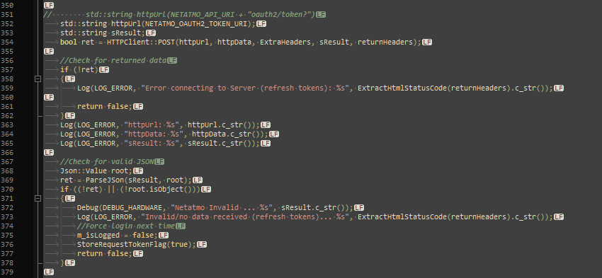

chrominator
Posts: 19
Joined: Sunday 25 December 2016 7:27
Domoticz version: 2024.7
Re: Netatmo authentication changes Oct 2022
Post by chrominator »
chrominator wrote: Tuesday 18 March 2025 6:23 Compiled from last source including PR from JurgenLB Return message when data is invalid. (#6276).
Error message is
2025-03-18 06:26:14.244 Status: Netatmo: Worker started...
2025-03-18 06:26:19.245 Status: Netatmo: Use refresh token from database...
2025-03-18 06:26:19.245 Status: Netatmo: Requesting refreshed tokens
2025-03-18 06:26:19.402 Error: Netatmo: Invalid/no data received (refresh tokens)... HTTP/2 403
I've made it working after a while, after a new compilation to be able to watch at the result of the posting for the renewal of the token.
This last until 3:45 this morning.
Now I've got the same error, with this html page as a result instead of the token refreshed.
Capture d'écran 2025-03-19 064650.png (8 KiB) Viewed 1389 times
In the transition between the expected behaviour and now, no change in Netatmo app nor in dz settings.
Hard to understand what makes now Netatmo blocking the request.
Hereunder the netatmo.cpp source modification, nothing magic in itself ;)
Capture d'écran 2025-03-19 064331.png (45.99 KiB) Viewed 1389 times
What is really weird is when I'm using with curl the content of the field httpData from my log after this failure, the Netatmo server send me back the expected refreshed token.
