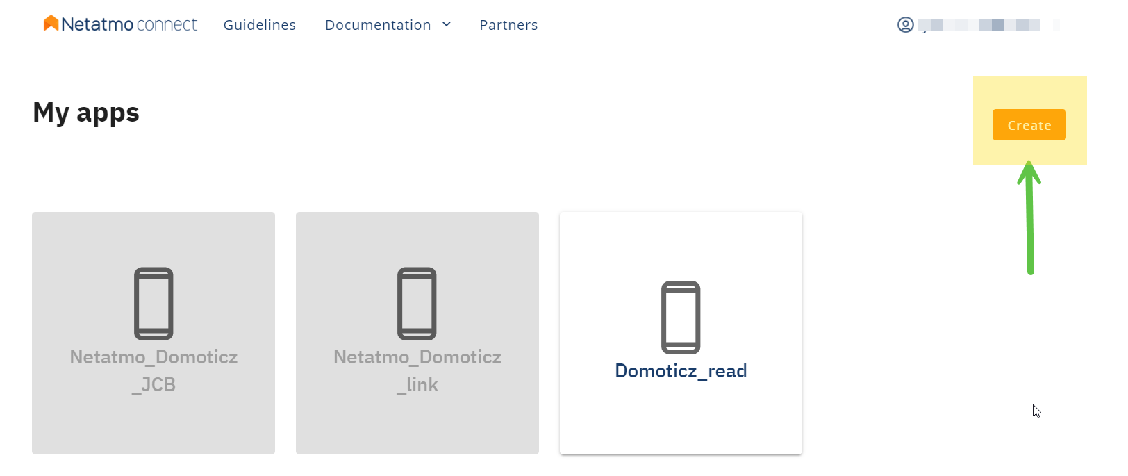

here are the steps to set up your devices:
  • Create an account on Netatmo to get access to device portal and log in
  • Create a new device (App) (or use an existing one) and leave the redirect URI and the webhook URI empty.
  • Use this app in only one single application; you cant use a single app in more than one applications. Create more apps when needed.
  • Press the Save button to store and activate the new app.
  • Do not use the token generator, because this will be done by Domoticz when login there.
  • Note the Client ID and the client secret or use another tab so you can use cut and paste to copy these codes.
  • On the Domoticz hardware page, create a new Netatmo device (or select an existing one.
  • Fill in the client ID and the client password (from the Netatmo device portal of the app you want to use.
  • Select the apropiate scopes for the Netatmo devices you own. You can select more items by holding the control button while selecting the items from the list.
  • Click on New to create a new device or on update to update an existing device.
  • Now, select the device again. When the login button is still gray, please refresh the page in your browser after a view seconds.
  • When it stays disabled you can change the client ID, like adding a character, press enter, remove the extra character, and press enter again. You might also change the scope , but don't forget to undo this change before the netxt step.
  • Press the login button.
  • When you are not logged in on the Netatmo site, a new window will pop upp with the NetAtmo login page.
  • Enter your Netatmo username and password (NOT the client ID and client passworrd!) to login.
  • After you are successfully logged in, a new page will be shown where you see the devices you have selevted by specifying the scope and you will be asked to accept the authorization of these devices.
  • After accepting the authorization, the window will be closed and disappears. This completes the login process
  • Check the logs to see if your device is working.

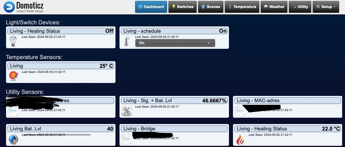

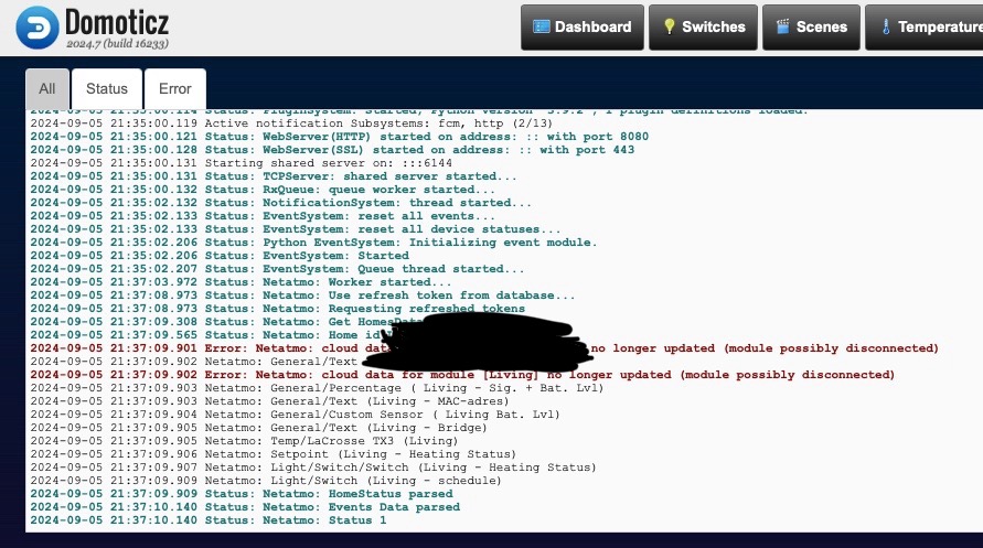

I did a new install from the last beta.
And using a installation from a family member with only a thermostat the devices are created.
Foto 5-09-2024 om 21.47.jpg (124.91 KiB) Viewed 2700 times
Foto 5-09-2024 om 21.38.jpg (156.98 KiB) Viewed 2699 times
The Error message is still shown but that is for another version.
Kind regards
