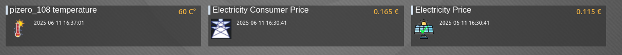

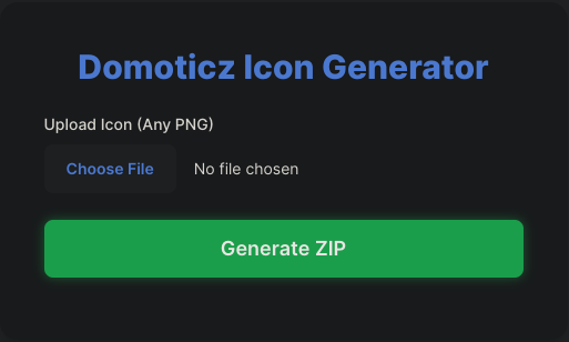

gizmo thanks for the example zip, I have now succeeded; the problem is https://domoticz- icon.aurelien-ve.fr there seems to be some problem as it creates a file in the zip with the extension 0 .
I enclose the files the first constructed manually
towerpower.zip
(8.45 KiB) Downloaded 133 times
the second built via the site
domoticz_custom_icon_towerpowerfailed.zip
(7.66 KiB) Downloaded 138 times
result :

I made this , it is to be saved in .html and used on a server works well .

Maybe you could let the author of this tool know that it sometimes generates icons with 0 byte length
I couldn't reach him, i don't have twitter/X, his GitHub is 404, and i don't have LinkedIn..
Also Nice, saves a lot of time making new icons!!

Post by Filip »
frank666 wrote: Wednesday 11 June 2025 20:54 tnx Ronka 👍
<!DOCTYPE html>
I like this tool? Just some suggestions: I would prefer the possibility to upload 2 different files; one for ON and one for OFF. Because sometime the OFF icon is not just a "gray" version of the ON one...
And would be good to have it somewhere in the domoticz git...

@Filip I have modified as suggested here :
<script type="text/javascript">
