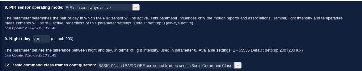

Domoticz's Setup tab allows one to change device attributes/parameters and the FIBARO Motion Device Parameter 8 has three states: PIR Sensor Always Active; PIR Sensor Active during the day only; PIR Sensor Active during the night only. While Parameter 9 defines the difference between day and night. Setting the PIR Active at night only and adjusting the day/night setting one effectively enables PIR during the night. I used the method domoticz.devices('Hall Motion Sensor').dump() but I do not see any variable that resembles the PIR Sensor Active parameter.
I have looked in the forum for examples of how to set parameters/attributes via DzVents and I see that most likely the settings of devices must be set with JSON commands.
Is this the correct path?

Maybe correct but do you really want to send this type of JSON ? Below you see the JSON that is send to one of my zwave devices to update one parm from 200 to 201elzorrovega wrote: Friday 08 May 2020 20:39 Domoticz's Setup tab allows one to change device attributes/parameters and the FIBARO Motion Device Parameter 8 has three states: PIR Sensor Always Active; PIR Sensor Active during the day only; PIR Sensor Active during the night only. While Parameter 9 defines the difference between day and night. Setting the PIR Active at night only and adjusting the day/night setting one effectively enables PIR during the night.
http://dz:8084/json.htm?type=command¶m=applyzwavenodeconfig&idx=8&valuelist=1_MTA%3D_2_MTU%3D_6_MzA%3D_9_MjAw_14_MjU1_16_MA%3D%3D_20_MTU%3D_22_MzA%3D_40_MjAw_42_MA%3D%3D_60_MTA%3D_62_OTAw_64_MA%3D%3D_66_MA%3D%3D_81_NTE%3D_82_MTAw_83_MTAwMA%3D%3D_86_MTg%3D_87_Mjg%3D_2000_NzIwMA%3D%3D_3_MiBwdWxzZXM%3D_4_MTIgc2Vjb25kcw%3D%3D_8_UElSIHNlbnNvciBhbHdheXMgYWN0aXZl_12_QkFTSUMgT04gYW5kIEJBU0lDIE9GRiBjb21tYW5kIGZyYW1lcyBzZW50IGluIEJhc2ljIENvbW1hbmQgQ2xhc3Mu_24_VGFtcGVy_26_VGFtcGVyIGFsYXJtIGlzIG5vdCBzZW50IGluIGJyb2FkY2FzdCBtb2RlLg%3D%3D_80_TG9uZyBibGluaywgdGhlbiBzaG9ydCBibGluaywgTEVEIGNvbG91ciBkZXBlbmRzIG9uIHRoZSB0ZW1wZXJhdHVyZS4gU2V0IGJ5IHBhcmFtZXRlcnMgODYgYW5kIDg3Lg%3D%3D_89_TEVEIGluZGljYXRlcyB0YW1wZXIgYWxhcm0u_

I am a firm believer in simple is beautiful; thus, I agree that the long JSON command to change one parameter is somewhat excessive . I would like to write a DzVents script which will "blind" the FIBARO Motion sensors when someone is at home to save battery life. For the moment, motion sensors only trigger Sirens when there is an intruder.
FIBARO FGMS001 Motion Sensor have the configuration pages as below and by changing these attributes they do not trigger when someone crosses the sensor's detection area.
The device dump() below does not give anything obvious where I could change the PIR Sensor Operating Mode. I see in the documentation that we have the device method rawData[!!].
Is this another way of reading/writing to the device? If this is the case, so then I guess it would be too easy to say write to the eighth element in the device table and set to 0, 1 or 2.
Your feedback is greatly appreciated.
Thanks for your reply.

rawData is not a method but the sValue field split into separate entries.elzorrovega wrote: Saturday 16 May 2020 17:42 I see in the documentation that we have the device method rawData[!!].
for example if sValue is 732.616;2297.2;164.007;101.857;1080.0;0.0 then
rawData[1] = 732.616
rawData[2] = 2297.2
rawData[3] = 164.007
rawData[4] = 101.857
rawData[5] = 1080.0
rawData[6] = 0.0
Not with a native dzVents command. So it is either manual or by the long JSON.Is this another way of reading/writing to the device? If this is the case, so then I guess it would be too easy to say write to the eighth element in the device table and set to 0, 1 or 2.

Don’t forget the motion sensor is battery powered, so it goes to sleep. Those settings will only be applied if the device wakes up, so it might not work as expected (unless you set the wake up interval to a very short value, but that might affect battery life).

The current Wake-up interval for the motion sensor is 900 seconds.
I was under the impression that commands were stored in a cue and the concerned device would read it's command after "waking-up".
Please find below the JSON messages.
P.S I checked on the site https://www.base64decode.org/ to be sure that the settings for _8_ are as in the GUI.
PIR sensor always active
PIR sensor active during the day only
PIR sensor active during the night only
- Can these be simplified so that only the concerned parameter (_8_) appears in the message or must we keep the rest of the device attributes as per examples below?
- Can this JSON call be made from within dzVents using the domoticz.openURL method or must one use a BASH command to execute it?
http://192.168.1.30:8080/json.htm?type=command¶m=applyzwavenodeconfig&idx=5&valuelist=1_MTA%3D_2_MTU%3D_6_MzA%3D_9_Ng%3D%3D_14_MjU1_16_MA%3D%3D_20_MTU%3D_22_MzA%3D_40_MjAw_42_MA%3D%3D_60_MTA%3D_62_OTAw_64_MA%3D%3D_66_MA%3D%3D_81_NTA%3D_82_MTAw_83_MTAwMA%3D%3D_86_MTg%3D_87_Mjg%3D_2000_OTAw_3_MiBwdWxzZXM%3D_4_MTIgc2Vjb25kcw%3D%3D_8_UElSIHNlbnNvciBhbHdheXMgYWN0aXZl_12_QkFTSUMgT04gYW5kIEJBU0lDIE9GRiBjb21tYW5kIGZyYW1lcyBzZW50IGluIEJhc2ljIENvbW1hbmQgQ2xhc3Mu_24_VGFtcGVy_26_VGFtcGVyIGFsYXJtIGlzIG5vdCBzZW50IGluIGJyb2FkY2FzdCBtb2RlLg%3D%3D_80_TG9uZyBibGluaywgdGhlbiBzaG9ydCBibGluaywgTEVEIGNvbG91ciBkZXBlbmRzIG9uIHRoZSB0ZW1wZXJhdHVyZS4gU2V0IGJ5IHBhcmFtZXRlcnMgODYgYW5kIDg3Lg%3D%3D_89_TEVEIGluZGljYXRlcyB0YW1wZXIgYWxhcm0u_
http://192.168.1.30:8080/json.htm?type=command¶m=applyzwavenodeconfig&idx=5&valuelist=1_MTA%3D_2_MTU%3D_6_MzA%3D_9_Ng%3D%3D_14_MjU1_16_MA%3D%3D_20_MTU%3D_22_MzA%3D_40_MjAw_42_MA%3D%3D_60_MTA%3D_62_OTAw_64_MA%3D%3D_66_MA%3D%3D_81_NTA%3D_82_MTAw_83_MTAwMA%3D%3D_86_MTg%3D_87_Mjg%3D_2000_OTAw_3_MiBwdWxzZXM%3D_4_MTIgc2Vjb25kcw%3D%3D_8_UElSIHNlbnNvciBhY3RpdmUgZHVyaW5nIHRoZSBkYXkgb25seQ%3D%3D_12_QkFTSUMgT04gYW5kIEJBU0lDIE9GRiBjb21tYW5kIGZyYW1lcyBzZW50IGluIEJhc2ljIENvbW1hbmQgQ2xhc3Mu_24_VGFtcGVy_26_VGFtcGVyIGFsYXJtIGlzIG5vdCBzZW50IGluIGJyb2FkY2FzdCBtb2RlLg%3D%3D_80_TG9uZyBibGluaywgdGhlbiBzaG9ydCBibGluaywgTEVEIGNvbG91ciBkZXBlbmRzIG9uIHRoZSB0ZW1wZXJhdHVyZS4gU2V0IGJ5IHBhcmFtZXRlcnMgODYgYW5kIDg3Lg%3D%3D_89_TEVEIGluZGljYXRlcyB0YW1wZXIgYWxhcm0u_
http://192.168.1.30:8080/json.htm?type=command¶m=applyzwavenodeconfig&idx=5&valuelist=1_MTA%3D_2_MTU%3D_6_MzA%3D_9_Ng%3D%3D_14_MjU1_16_MA%3D%3D_20_MTU%3D_22_MzA%3D_40_MjAw_42_MA%3D%3D_60_MTA%3D_62_OTAw_64_MA%3D%3D_66_MA%3D%3D_81_NTA%3D_82_MTAw_83_MTAwMA%3D%3D_86_MTg%3D_87_Mjg%3D_2000_OTAw_3_MiBwdWxzZXM%3D_4_MTIgc2Vjb25kcw%3D%3D_8_UElSIHNlbnNvciBhY3RpdmUgZHVyaW5nIHRoZSBuaWdodCBvbmx5_12_QkFTSUMgT04gYW5kIEJBU0lDIE9GRiBjb21tYW5kIGZyYW1lcyBzZW50IGluIEJhc2ljIENvbW1hbmQgQ2xhc3Mu_24_VGFtcGVy_26_VGFtcGVyIGFsYXJtIGlzIG5vdCBzZW50IGluIGJyb2FkY2FzdCBtb2RlLg%3D%3D_80_TG9uZyBibGluaywgdGhlbiBzaG9ydCBibGluaywgTEVEIGNvbG91ciBkZXBlbmRzIG9uIHRoZSB0ZW1wZXJhdHVyZS4gU2V0IGJ5IHBhcmFtZXRlcnMgODYgYW5kIDg3Lg%3D%3D_89_TEVEIGluZGljYXRlcyB0YW1wZXIgYWxhcm0u_
