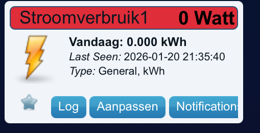

Re: Enphase verbruik
Posted: Wednesday 21 January 2026 22:08
by edwin1234
Now i have this:Image
But still no value in domoticz
Posted: Thursday 22 January 2026 9:39
by FireWizard
Hi @edwin1234,
Something else is wrong.
I do not understand, that you produce 1124W at 22:03:07 on January 21st. Or is it the Northern Light :lol:
Correct this first.
