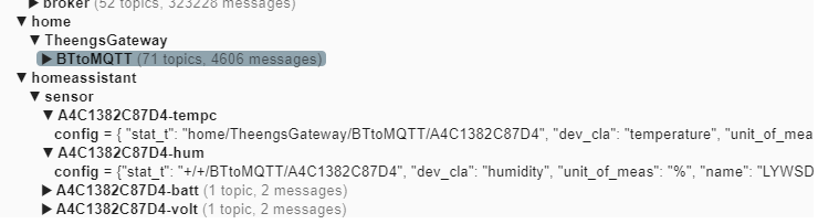

Re: Autodiscovery with TheengsGateway
Thanks very much walter.
I have got hass-discovery turned on (I think) by leaving it to its default. Were you suggesting that I should not? Will give that a go.
It seems to be creating the nodes in MQTT (but I don't 100% know what they should look like)
I added an attachment with a screenshot but when try to add it inline I get a post error about it being an external image. (User error I am sure but can't see quite how...)
I have created a Domoticz MQTT auto discovery with homeassistant as the prefix and that seems to be working (I think) because it is picking up the ZWave nodes.

As I posted this, I do notice that the path to the status topic used by TheengsGateway seems to use a 'wildcard' in the path but the ZWave topic details the specific path. I wonder if I can use the -pt option in TheengsGateway to force it to use a full path. Will give that a go too.
The homeassistant message being posted is:

"manufacturer": "Xiaomi",
"model": "LYWSD03MMC_ATC",
"name": "LYWSD03MMC-5DBC50",
"via_device": "OMG_BLE"
"id": "A4:C1:38:5D:BC:50",
"mac_type": 0,
"name": "ATC_5DBC50",
"rssi": -84,
"brand": "Xiaomi",
"model": "LYWSD03MMC",
"model_id": "LYWSD03MMC_ATC",
"tempc": 23.7,
"tempf": 74.66,
"hum": 50,
"batt": 81,
"volt": 2.936
