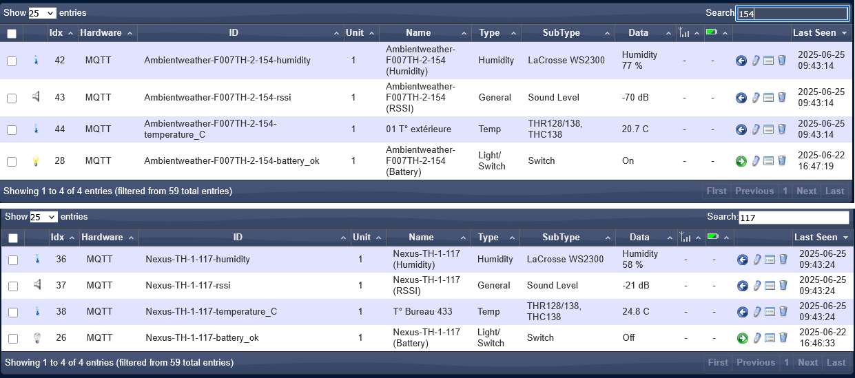

I read these posts with much interest.
I am using the openMQTTGateway on an ESP32 to monitor a few 433 devices in Domoticz through Mosquitto. It works, but I noticed a small problem: previously I was using and rfxTRX433 usb device and each sensor was combined [ie. a temp + humidity sensor ends to a single temp + humidity (+signal strength) in Domoticz], now, in Domoticz, I have 4 devices created for each 433 sensor: One for the temperature, one for the humidity one for the signal strength (but with the "sound level" type!) and one for the battery.
When reading your posts, it seems that in the same (nearly) situation, you have a combined temp+humidity device in Domoticz.
I don't find any way to get a combined device. Could you help me?
He is some detailed information:

trace from the openMQTTGateway:
MQTT autodiscovery config topics
And the result in Domoticz:

Thanks for your answer. Do you mean that Domoticz would combine if there was only temp and humidity, but as there is also battery and signal strength Domoticz has no combined device and decides not to combine temp + humidity on one side and let battery and signal strength single?Doler wrote: ↑Wednesday 25 June 2025 15:30 From that I learned that Domoticz tries to combine device attributes when the device name is the same. I guess that in your case Domoticz gets confused since all device attributes have the same device name (eg "mdl":"Nexus-TH","name":"Nexus-TH-1-117"). When battery and signal strength would have different names Domoticz would combine temperature + humidity.
By the way when receiving the same device with my rfxTRX433, the single created device has temp + humidity + Signal strength seen in the setup/devices tab and maybe battery state but not directly visible.

I see a unique_id in the config topic payload that is made up like
ID_type_gateway eg "unique_id":"0x00158d0004a98668_humidity_zigbee2mqtt"
and
"unique_id":"0x00158d0004a98668_temperature_zigbee2mqtt"
Yours is ID-type (so no underscore)
"uniq_id":"Ambientweather-F007TH-2-154-temperature_C" and "uniq_id":"Ambientweather-F007TH-2-154-humidity"
I am not sure what exactly the logic is here to have Domoticz combine the topics.

Yes it is the Unique ID you have to look at
- Posts: 5852
- Domoticz version: 2024.7
Re: Autodiscovery with TheengsGateway
But what is the logic behind it? How should that unique ID look like to get Domoticz combine the Temp+HUM sensor?
When I look at these 2 unique ID's, what is wrong with it?
Is it the missing underscore? Is it the _C on the end for the temperature? is it the gateway "RTL_433toMQTT" missing on the end?
- gizmocuz
- Posts: 2548
- Location: Top of the world
These are mine unique-id's
0x00158d0004a98668_pressure_zigbee2mqtt
There are no unique id's in the above config. That's a first issue... there is no way telling if they belong to each other

By "above" you mean your 3 lines or the 2 ""uniq_id":"Ambientweather-F007TH-2-154-...." lines ? In both case, I do not see the difference except yours begin with a number....gizmocuz wrote: ↑Thursday 26 June 2025 13:13 These are mine unique-id's

No, inside the config object payload

Ambientweather-F007TH-2-154 seems to be the unique ID string like 0x00158d0004a98668 for zigbee2mqtt.

Hmmm I see, it is using the short format of all variables....
there is a "uniq_id"
Ahh pfff now I see
The configs are a bit of a mess... If you use short-format, stick to short format!
"device" should be "dev"
Or use "device", but use "identifiers" instead of "ids"
But in this case, all is using the short format, so stick with short and don't mix

OK, I think I understand.
Would it be hard to allow mixed format to allow ["dev" + "identifier"] and ["device" + "ids"] mixed combinations? maybe (MQTTAutoDiscover.cpp at line 669):

No this is not an issue with Domoticz and has to be fixed by the one creating these config objects.
You, on the other hand, can edit/replace your own config object, and consider this a 'fix'
But it has to be fixed upstream.
