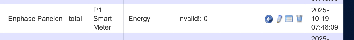

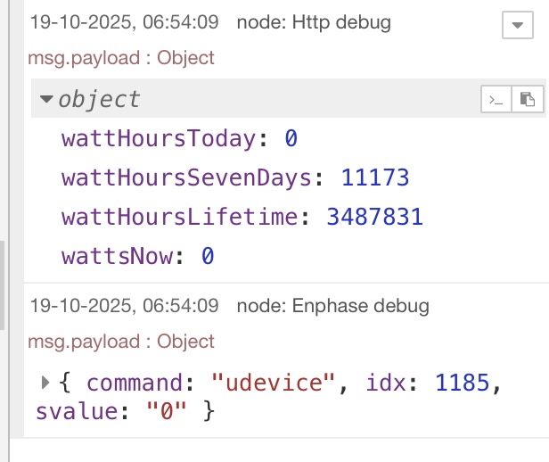

Whats wrong here in node red,
I get an error in domoticz that invalid data is send from node red
What is wrong here?

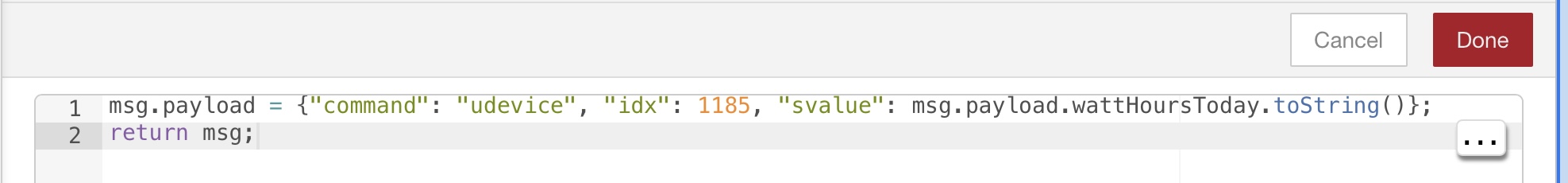

You have to follow the Domoticz API/Mqtt rules and send all the requesedt values for the P1 smart meter device It needs 6 values in the sValue and not only one.
For this power plug (?) a P1 smart meter is not correct, you need the Domoticz electric (instant + counter) device.
For instant you send the WattsNow value, for counter the Wattshourslifetime value.

Long ago gizmocuz used a P1 Smart meter device for the native Enphase integration, but changes that to an Instant +Counter device, because a solar production differs from a P1 device.
In Node Red nothing is wrong, but you send the data in the wrong format for that sensor.
