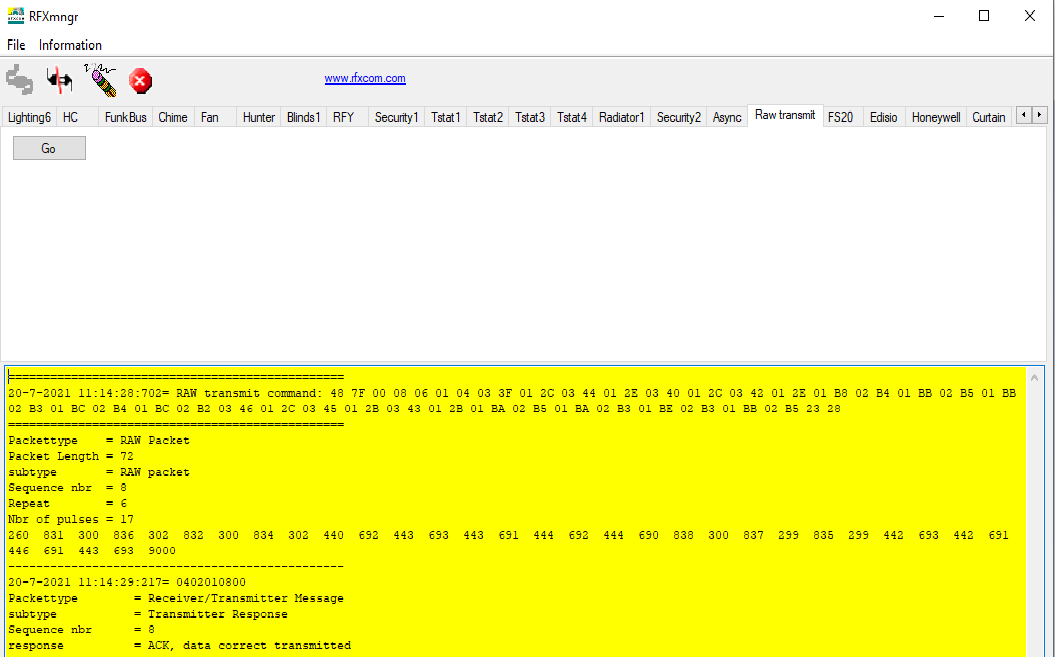

You need to run the command in rfxmgr and note the actual RAW code it generates in the yellow window.
Then paste this IN QUOTES into the command.

From this screen, what code do I need. The line between the '=====' or the line beneed the Nbr of pulses?

The bit between the double lines after "command"..it needs to be in quotes to work in the script.
"48........28"
