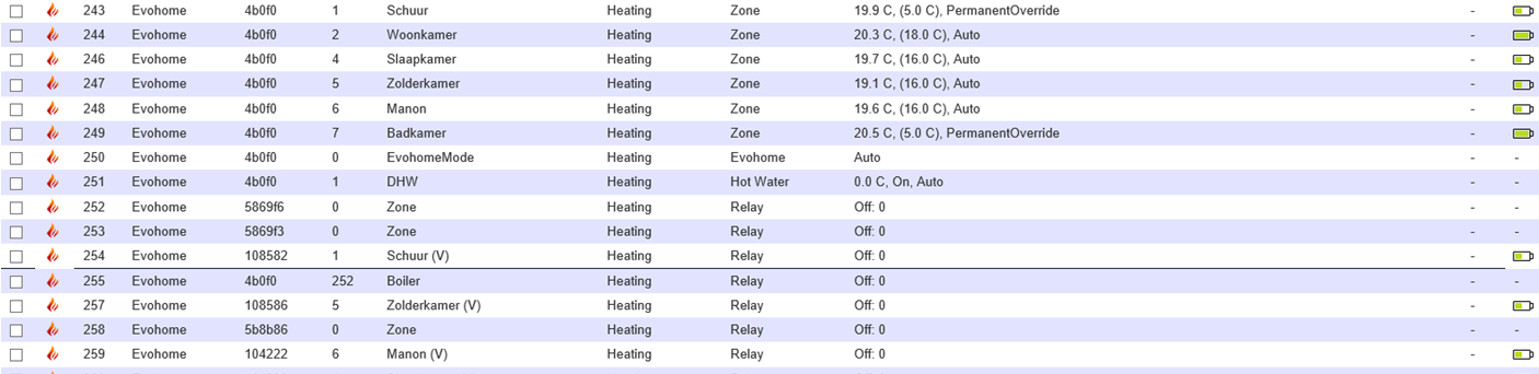

There is still one strange thing the relay "Schuur (P)".
If i manually change the state on the physical device, then no event is triggered.
So the device attributes are not correct.
I bound the relay 'Schuur (P)' in the 'Hardware tab' with the 'Bind Relay' (See attachment).
About the batterylevel:
In the old environment all the evohome zone devices and some of the Relay devices showed the batterylevel in the devices tab.
Now only one zone device shows the batterylevel ( See attachments )
Greetz Bert

Will push the fix of the evohome device adapter to the next BetaBertvdw wrote: Tuesday 29 October 2019 23:11 I changed the evohome_device.lua file like you asked. Now i can use the attibute state again.
I have no clue on the relay stuf. Maybe one of the other forum members can help.
Reported the battery issue on Github. Hopefully someone can shed some light on this.
