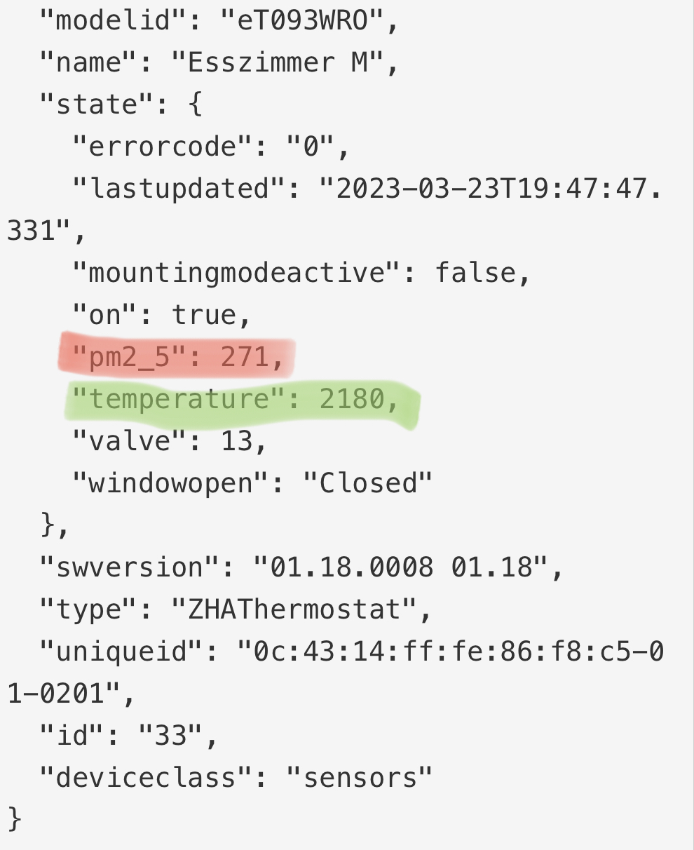

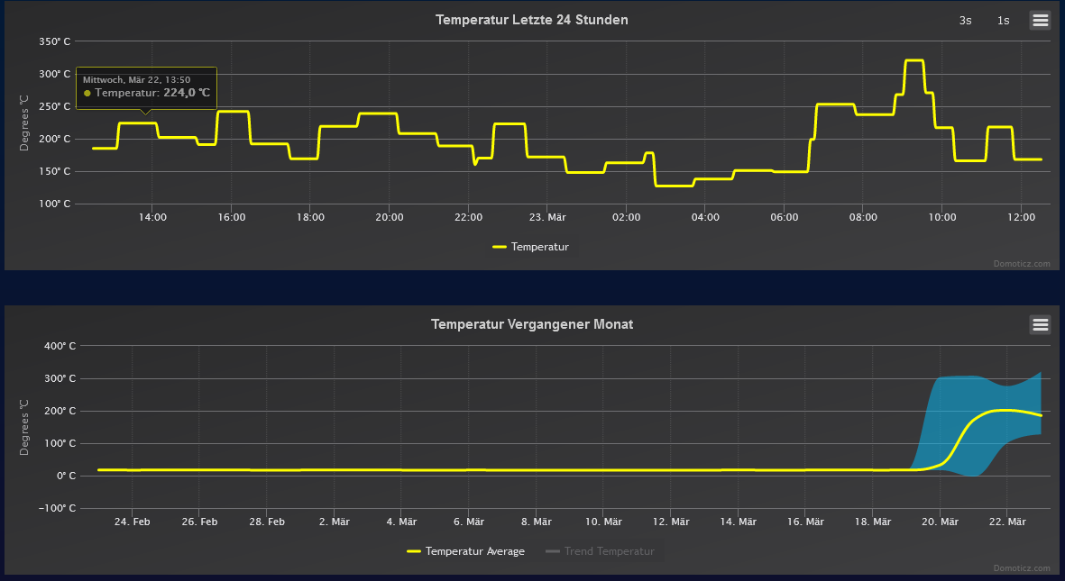

With update to domoticz 2023.1 the temperature readings of danfoss ally thermostats are incorrect.
Python Version: 3.7.3 (default, Oct 31 2022, 14:04:00) [GCC 8.3.0]
The are the room tempature reading from the thermostat and not the setpoint value. In phoscon the value are correct.

It don't make 224 °C in your home ?
Seriously, you are sure it's from domoticz update ? You haven't updated deconz or the plugin itself in same time ?
Values need to be / 10, but I don't see what have moved. You have this issue only for thoses TRV not other temperature sensor ?
Can you check the raw value ? it's state/temperature, you can found the complete json in the front end (custom/deconz/sensor) or in phoscon/help/API Information / sensors.
Do you know wich one plugin version you have ATM ?

In fact I don‘t really know if it appears just with the domoticz update or I‘ve updated also the plug-in.
But for testing I set up a second Testsystem with the newest versions and only deconz plugin as hardware with same results.
Very good hint to check the API. I have the issue only on the TRVs and found the origin of the value. It’s not only multiplied but a whole different one.
On them I‘m running a custom deconz DDF to have functionality not yet implemented proberly. I recycled a existing item and the plugin takes this state/pm2_5 and not the state/temperature. But I‘m running this DDF since month and never faced that issue.
So how the plugin pick the right state/temperature?

Ha yes, so I think I have understand.
This is an order for state, so the plugin update first the temperature (and / 100) and the value will be 21.80°C , but just after it update the widget with pm2.5 (there is only 3 widget for TRV, a temperature one, a mode one, and a setheatpoint one), so you will have as value 271 °C.
I probably can do something on plugin side, but wich one value you try to get with this "hack" ? pm2.5 are more for ZHAAirquality, what is the missing one for you ?

But why the plugin takes now the pm2.5 and not the temperature anymore and the value seems not to be divided at all? Is the plugin just locking for the 5th state attribute?
Can you may give me a hint in which line in the python script I can find this, so I can have a look by myself?
I‘m using this pm2.5 just because it is defined to be used on a deconz DDF and not used by TRVs usually. The ally TRVs have a Load Balancing feature that allows to balance the radiators heating load when there are more than one in a room. With the pm2.5 I make the estimated load which is calculated by each TRV available in the API.
My goal is not to have this value available in domoticz via the plugin, I just pull this value through a API call in my Dzvents scripts, but nevertheless it would be useful. But I think it is better to wait that this estimated load is properly introduced to deconz later.
I just want the right temperature readings back.

The plugin is moving, pm2.5 was probably not managed previously, there is some evolution time to time ^^, like the support for zigbee keypad for exemple Add zigbee keypad to domoticzBut why the plugin takes now the pm2.5 and not the temperature anymore and the value seems not to be divided at all? Is the plugin just locking for the 5th state attribute?
And values are not divided for pm2.5.
As fast patch, we can just change the order in the fonction.py, just need to put "temperature" after "pm2_5" in the fonction
def ProcessAllState(data,model,option):
I can use something better in the code, but in reality TRV will never have "pm2.5", so will be not used a lot.
Can you give me the attribute used on your DDF and how you want to call it "config/XXXXX" I can make a PR to have it offcialy ? will be better than use pm2_5.

Yeah, software is moving, it’s totally okay.
I just want to understand why the update broke the temperature readings with my DDF. I understood that the issue appear because the pm2.5 is now supported. Why the temperature value is replaced by the pm2.5? How is the API state linked to the domoticz device?
I‘m just interested how this works.
I already gave my input to this GitHub issue:
https://github.com/dresden-elektronik/d ... /issues/13
And we discussed also in the deconz forum.

Yeah, almost impossible having all devs agree with a change (and can take months). But making a small PR with only 1 field have more chance to be valided, if I have understand you need "state/LoadEstimateOnThisRadiator" ?
It's realy usefull for you ? because on my side I don't see what to do with this value.
When deconz send a websocket return, the contain is parsed, config part is managed by (2) and (3), and state by (1), there is no check in this part because on TRV only temperature is used, TRV don't have pm2.5 at base. In your situation pm2.5 overwrite the temperature value.
To solve the problem we can :
- add a check to use only tmperature and not pm2.5, but this situation need don't happen.
- use temperature after pm2.5, I think I will do that but I need to be sure there is no other widget impacted by this change.
- make something to avoid this hack in deconz ^^. An official PR.
- use a field other than "pm2.5" not used by the plugin (but can be used later)
Honnestly I think we can try the third solution and if they don't validate the PR, I will make the second.
You can make the second solution waiting for something official to have good temperature.
Realy simple, at start the plugin create 1 or more widget by device, 3 for TRVs, 1 temperature (1), a mode (2) and a Setheatpoint (3).Why the temperature value is replaced by the pm2.5? How is the API state linked to the domoticz device?
