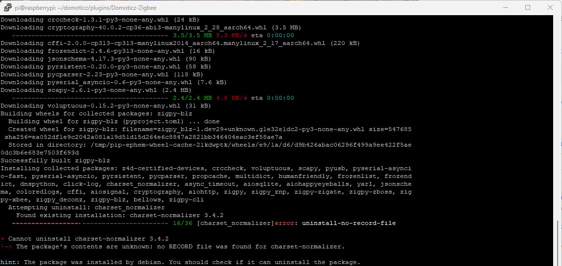

I am trying to upgrade from Bookworm to Trixie, the upgrade was failing during the os upgrade, so i tried a clean Trixie install. Domoticz is running, only the Z4D plugin is giving problems during the plugin installation. The P1, Somfy and all other is working. The plugin is failing during the requirements.txt, see attachment. Hou to resolve this?
Edit:
Maybe this has something to do with the virtual evironment. I have to check this first.
Zigbee 4 Domoticz install fails on fresh install Trixie Topic is solved

- Z4D_Trixie _fail.jpg (180.12 KiB) Viewed 196 times
- Posts: 6676
- Domoticz version: 2025.1
Re: Zigbee 4 Domoticz install fails on fresh install Trixie
Perhaps check this: https://zigbeefordomoticz.github.io/wik ... d-cchardet
Thanks Walter,
The problem was the Vitual Environment. I followed (again) the wiki for installing on Bookworm with virtual evironment. As test i run now Trixie with Domoticz stable 2025.2, no errors in the log now, everything is working ok now.
