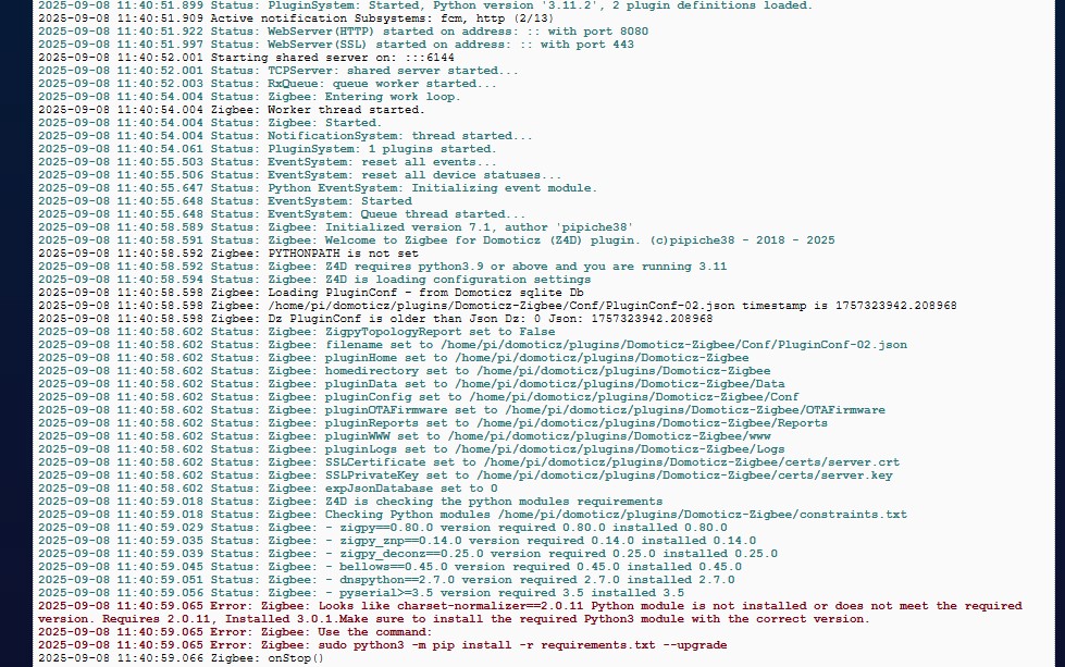

I am trying to make a new domoticz install, new Domoticz 2025.1 stable on Bookworm, RPi 3B+. Everything seems to work ok but only the Z4D plugin starts with an error.
I have tried the suggestion in red, but that doens't resolve. What could be the problem?
This setup runs without problems on Bullseye.
Z4D does not start on new instal Topic is solved

- Zigbee_python_Fail_2.jpg (271.46 KiB) Viewed 94 times

You could try to do
sudo pip3 install --force-reinstall --upgrade charset-normalizer==2.0.12Domoticz running on Udoo X86 (on Ubuntu)

Re: Z4D does not start on new instal
With bookworm, you need to configure a python virtual environnement.
Please have a look here : https://zigbeefordomoticz.github.io/wik ... alEnv.html
I have followed this procedure, Zigbee is working now.Deufo wrote: Monday 08 September 2025 13:57 Hello,
