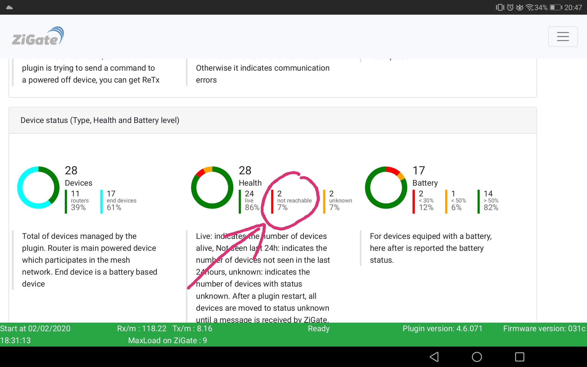

With last beta plugin and domoticz 411670 I think something is not working properly because some devices become offline after a few minutes after last use or last polling but not always and become online after a period but
these devices are always connected. I think it should go offline after a longer period of inactivity and only when not responding to polling.
