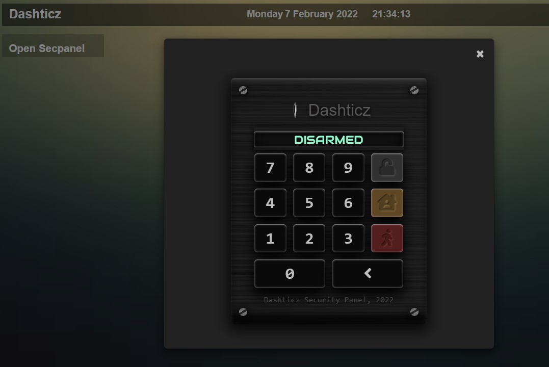

Try the following:
var blocks = {}
blocks['spbutton'] = {
    title: 'Open Secpanel',
    popup: 'secpanel',
    framewidth: 500,
blocks['secpanel'] = {
    scale:0.7
var columns = {}
columns[1] = {
    blocks: [
    'spbutton'
    width: 2
This will give:
No need to use custom.css

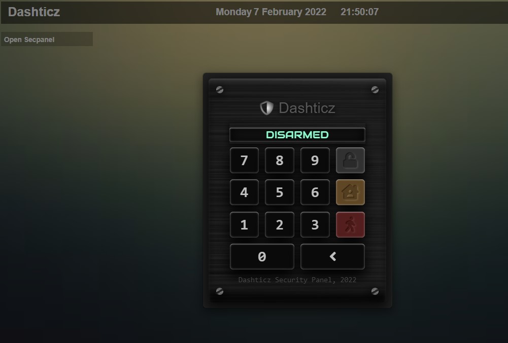

To make the popup window exactly fit the security panel, we have to change it a bit:
var blocks = {}
    popup: 'secpanel',
    framewidth: 300,
var columns = {}
columns[1] = {
    blocks: [
    'spbutton'
    width: 2
and in custom.css:
#popup_spbutton .modal-dialog {
    min-width: 1px !important;
    height: unset !important
#popup_spbutton .frameclose {
    display: none
This will give:

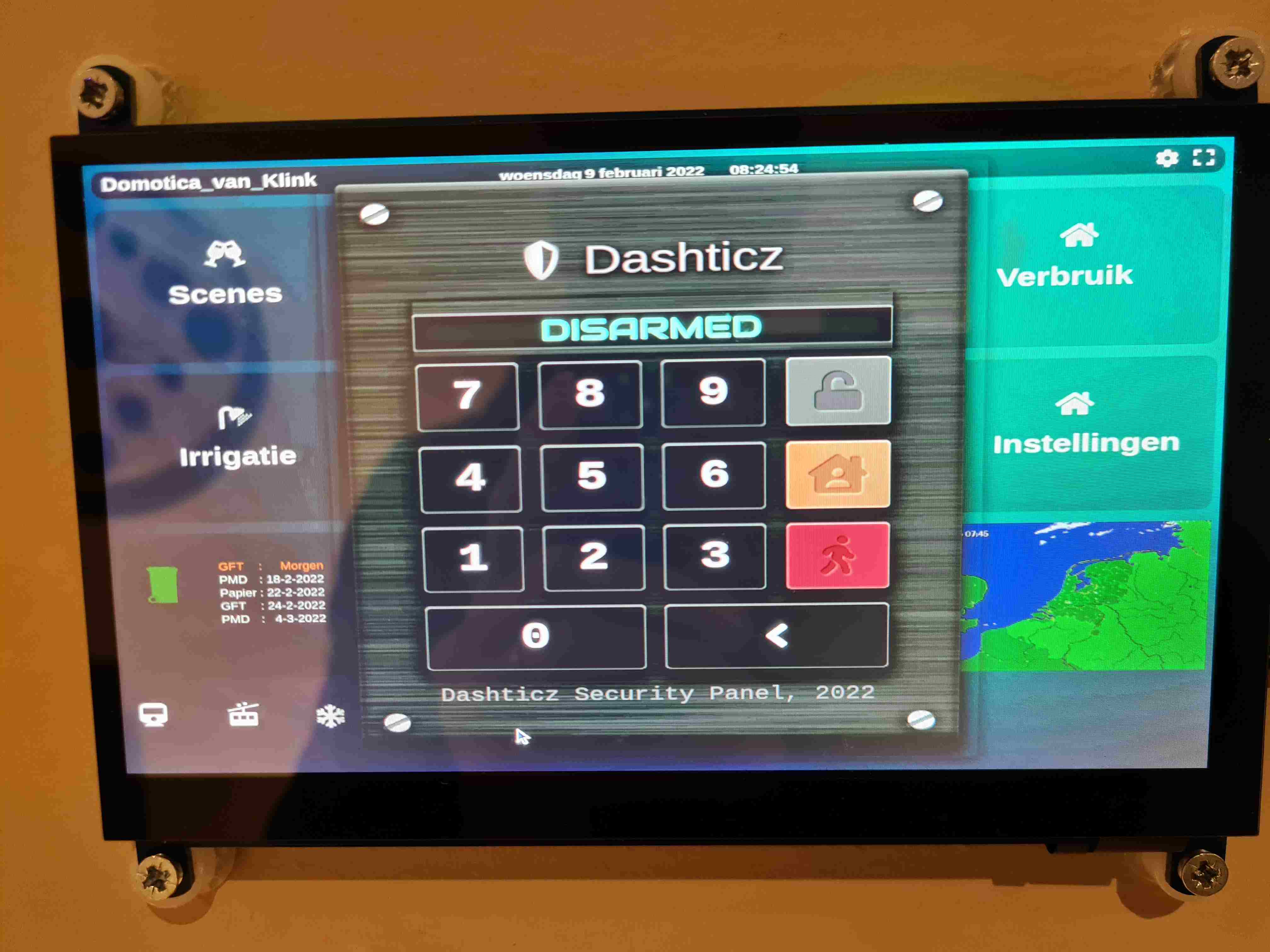

It works GREAT!
i normally use the buttons.<name> construct for this, but this is even better!
I can close the popup by clicking anywhere on a empty part of the canvas....
question
is it preferred to use blocks for buttons and to avoid the button.<name> construct ?
Question
is #popup_ the default prefix to style popups in css for a defined block ?
This is the result :-) (new dashboard for my wall screen)

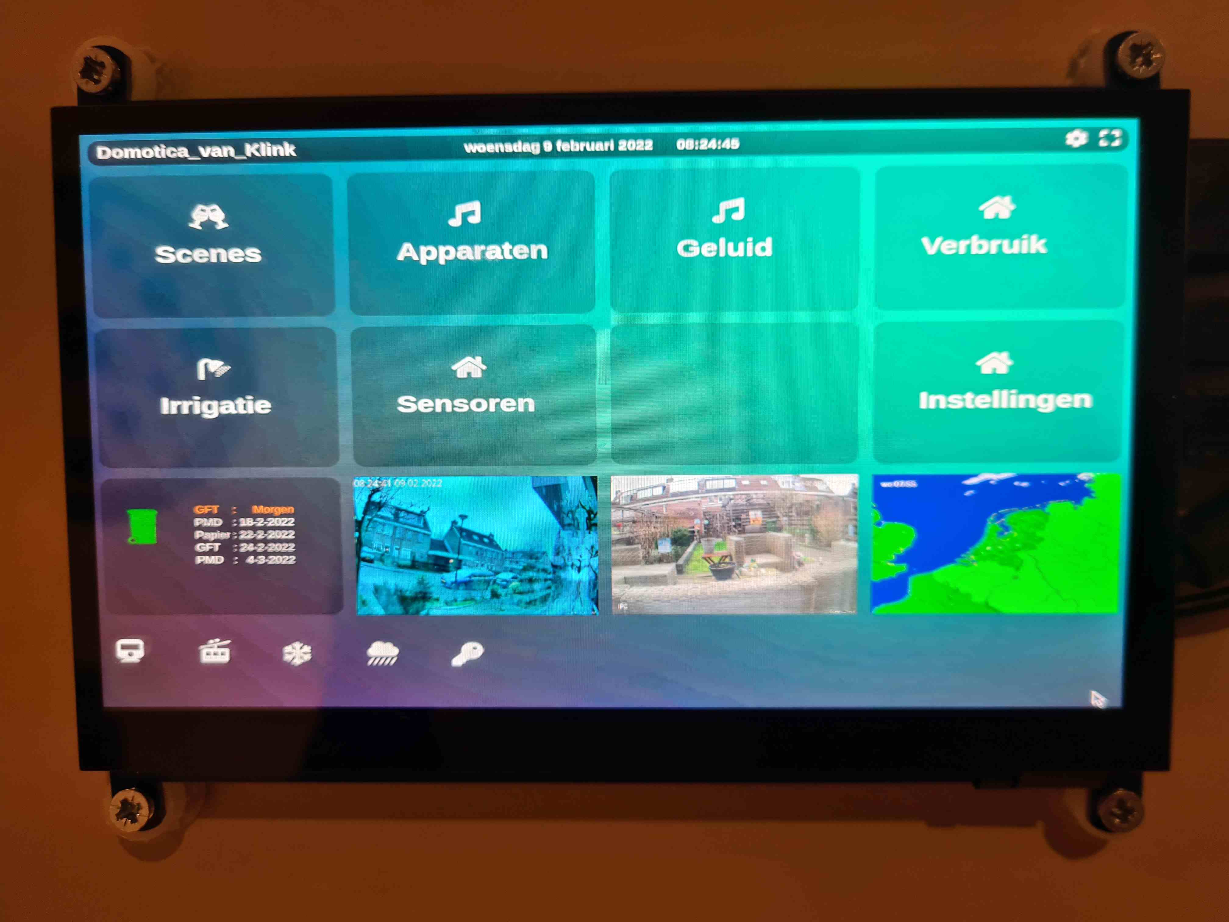

I rewrote all my buttons, and it works perfect with blocks...
My wall dashboard is functional finished!
I have one page left with a styling issue , its acting strange with a combination of dials an select objects.
On a big desktop screen it is perfect but on my wall-touch screen it skips one block
Strange because 8 dials do fit...
Jablotron connection, Ikea
pvklink
Posts: 822
Joined: Wednesday 12 November 2014 15:01
Domoticz version: latest b
Re: sec panel height in a popup initiatd by a button not adjustable
Post by pvklink »
solved it by making two colums, left the dials, right, de buttons.
Not the proper way, but it works..
Dashboard finished...
I will publish it to the my dashboards part (thanks everybody)
