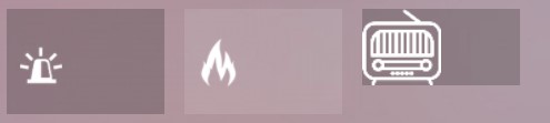

Also here's what happens when using your code:
Lokonli
Posts: 2292
Re: Dashticz - Center Button Image (icon)
Post by Lokonli »
Which browser and OS do you use?
Can you post your CONFIG.js, custom.css and custom.js?

Lokonli
Posts: 2292
Post by Lokonli »
If you add the block 'media' to a column via 'blocks.media' then the key is not defined, and the data-id='media' will not work.
You can add key:"media" to the block definition explicitly, or just add the block via string identifier "media" to a column, like:
 blocks:  [ buttons.page0, buttons.page1, buttons.page2, buttons.page3, buttons.page4, buttons.page5, buttons.page6, "media", "clock2"],
Some more background info:
You can add blocks to a column in two ways:
1) inline block definition
2) string identifier
The buttons.page0 .. page6 blocks you have are inline block definitions.
"clock2" is a string identifier.
If you use a string identifier, then dashticz searches for blocks[string_identifier] for the block definition, and adds as parameter key: string_identifier to the block definition as well.
If you add a block via blocks.string_identifier, then Dashticz will add the block via the inline block definition method, but in that case the key parameter can not be added automatically.
So instead of the blocks['media'] block, you also could define your block with:
buttons.page7 = { key: "media", width:1, btnimage: "img/radio.png", slide:8};
and add to a column via buttons.page7
Note that image parameter is relative to the ./img/ folder, while btnimage is relative to root ./
