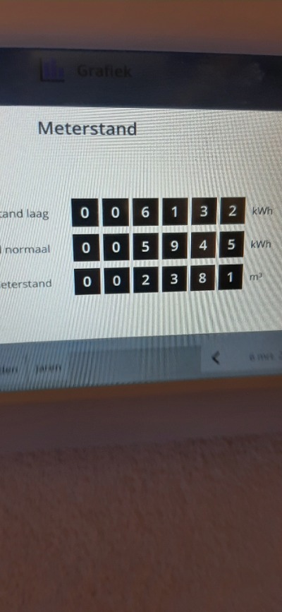

I want to have the following. My P1 meter has a data field
Data: "6132890;5945574;0;0;313;0",
result: [
AddjMulti: 1,
AddjMulti2: 1,
AddjValue: 0,
AddjValue2: 0,
BatteryLevel: 255,
Counter: "12078.464",
CounterDeliv: "0.000",
CounterDelivToday: "0.000 kWh",
CounterToday: "3.735 kWh",
CustomImage: 0,
Description: "",
Favorite: 1,
HardwareDisabled: false,
HardwareID: 2,
HardwareName: "P1 meter",
HardwareType: "P1 Smart Meter USB",
HardwareTypeVal: 4,
HaveTimeout: false,
LastUpdate: "2021-03-06 12:26:35",
Name: "P1 Elektra",
Notifications: "false",
PlanID: "0",
PlanIDs: [
0
Protected: false,
ShowNotifications: true,
SignalLevel: "-",
SubType: "Energy",
SwitchTypeVal: 0,
Timers: "false",
Type: "P1 Smart Meter",
TypeImg: "counter",
Unit: 1,
Usage: "313 Watt",
UsageDeliv: "0 Watt",
Used: 1,
XOffset: "0",
YOffset: "0",
idx: "1"
Something like this would be ideal.

Maybe for now you can use the following codes (change 274 and 320 to your own IDX):
blocks['blocktitle_1'] = {}
blocks['blocktitle_1']['title'] = 'Meterstanden'
blocks['274_8'] = {
	idx: '274_8',
	title: 'Meterstand laag',
blocks['274_7'] = {
	idx: '274_7',
	title: 'Meterstand normaal',
blocks['320_2'] = {
	idx: '320_2',
	title: 'Meterstand',
columns[1] = {}
columns[1]['blocks'] = ['blocktitle_1','274_8','274_7','320_2']
columns[1]['width'] = 5;
Blah blah blah

HansieNL wrote: Sunday 07 March 2021 10:27 Maybe for now you can use the following codes (change 274 and 320 to your own IDX):
blocks['274_8'] = {
	idx: '274_8',
blocks['274_7'] = {
	idx: '274_7',
blocks['320_2'] = {
	idx: '320_2',
columns[1] = {}
