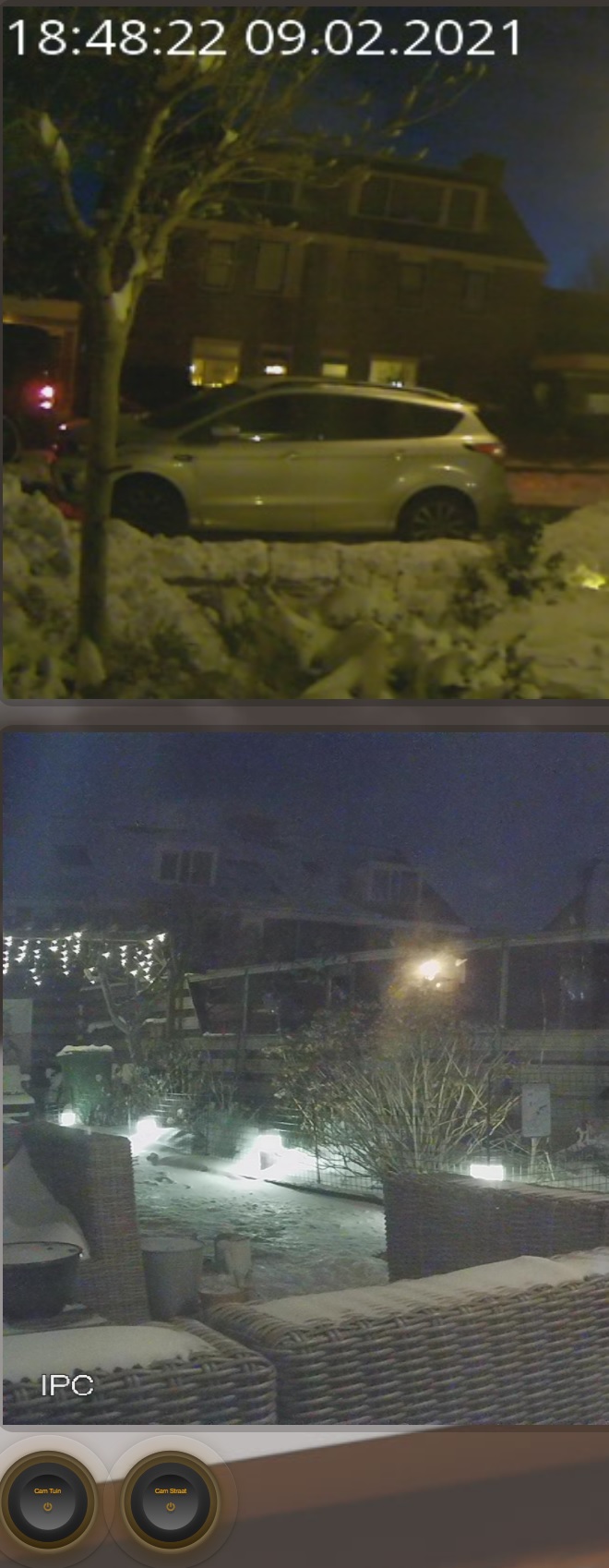

Re: Latest beta and Camera blocks
Post by pvklink »
Solved it!
By adding two small dials, for each cam one. This dial activates the cam so you can type in username/password.
Aftering entering usernames/passwords, the camera block works!
