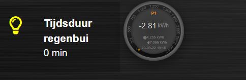

Hello Forum,
Recently the Dashticz dashboard was introduced to me by family and now i expanded it with some features documented in the manual.
Now i am trying to make a dial view from the P1 smart meter, but i can't get it working as a dial.
I presented the same device [6] als as a graph and don't now if that is (part of) the problem.
I use the following code to present the device as dial:
blocks['p1'] = {
devices : [6],
title : 'P1 Smart Meter',
Type : 'dial',
width : 10,
min : -100,
max : 100,
showring : true,
showunit : true,
shownumbers: true,
last_update: false
I hope you can give me some tips to solve the problem.
Thank you in advance.
Frans

It's case sensitive.
Use 'type' not 'Type'

Thank you, that worked.
I better read better next time.
Reg Frans

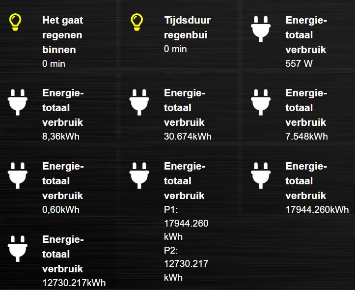

Hi, I'm also trying to add the dial function to my dashticz dashboard, no luck sofar.
Need some advice in this.
The block config:
This is the result:
The block config:
blocks['Energie'] = {
idx: [318],
title: 'P1',
type: 'dial',
width: 2,
min: 0,
max: 2500,
showring: true,
showunit: true,
shownumbers: true,
showvalue: true

idx should not be an array, but just a number, like:Bospieper wrote: Sunday 18 September 2022 22:29 Hi, I'm also trying to add the dial function to my dashticz dashboard, no luck sofar.
The block config:This is the result:Code: Select all
blocks['Energie'] = { idx: [318], title: 'P1', type: 'dial', width: 2, min: 0, max: 2500, showring: true, showunit: true, shownumbers: true, showvalue: true }
idx: 318,

Hi Lonkonli,
Unfortunately no change after adjusting the idx
Piet
Piet

How did you add the block to a column?
You should use 'Energie'
Verstuurd vanaf mijn SM-A526B met Tapatalk
