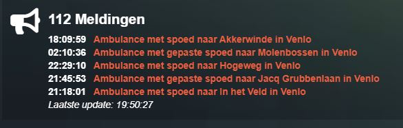

After using Dashticz for a while now i decided to return something.
I wrote a custom js script to display the last x 112 Alarm messages on my dashboard.
To use this on yourdashboard:
Copy the alarmmeldingen.js to your /js/components directory.
alarmmeldingen.js
(3.33 KiB) Downloaded 308 times
Edit the dashtics.js file in the /js directory and add this line just before the 'secpanel' line:
 'alarmmeldingen',
Then add the configuration settings to your config.js file in the /custom folder:
var alarmmeldingen = {
  rss: 'http://www.alarmeringen.nl/feeds/region/rotterdam-rijnmond.rss',
  city: 'Poortugaal,Rhoon,Hoogvliet,Traumaheli,Pernis',
  show_lastupdate:true,
  width:12,
  interval: 180,
  results: 5}
Get the rrs link from the site http://www.alarmeringen.nl/ in this case i used my region 'Rotterdam-Rijnmond
With the city variable you can filter the messages for your town and if you want the cities around you. Use Traumaheli to get all alarms containing the support of the Trauma Heli
If you would like to have an icon in this block you can use the icon: variable
icon: 'fas fa-bullhorn',
The interval defines the refresh rate in seconds
results defines the number of resent results to show.
To use the formatting in my screenshot add these values to the custom.css file in the /custom folder.
.alarmrow{
    font-size: 14px !important;
.alarmrow a {
  color: white;
.alarmrow strong{
    display: inline-block;
