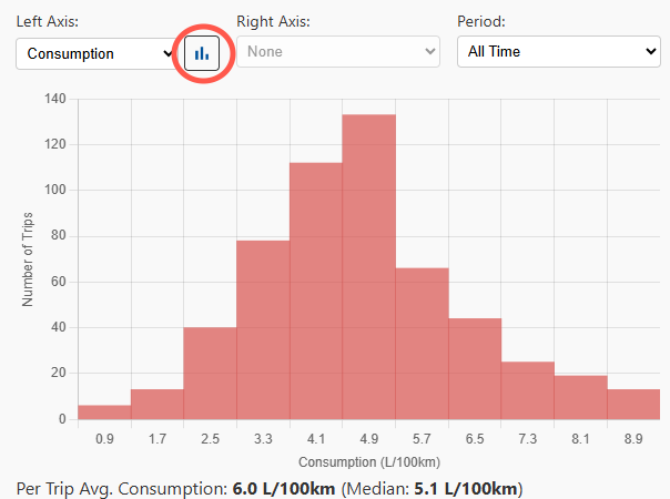

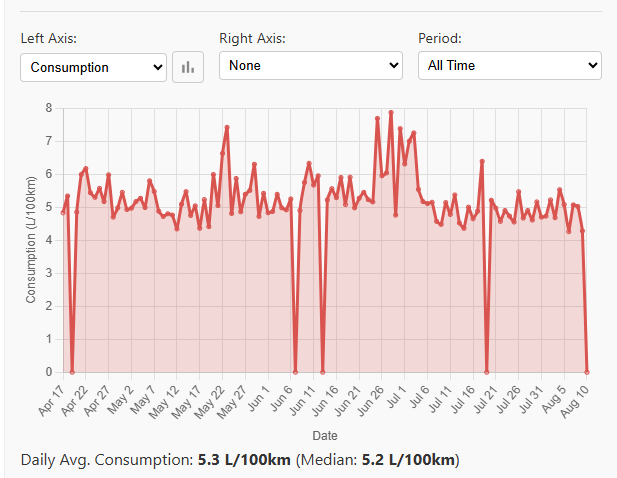

I can add an "export to CSV" option in the trips history page so you can export the data directly without domoticz in the middle.
The logs you provided, did not contain any trips log, so i dont know if and how pytoyoda fetches the fuel consumption for your car. If you can send me such a log, I can integrate it. If pytoyoda does not get that data, we can probably still solve it either by hooking directly into the response from the toyota server (pytoyoda is not storing all data it gets) or by closely tracking the battery level before and after each trip, though this will be more prone to errors.
I can also add specific fuel consumption calculations to the web server if you let me know, what you are missing.
You can also click the histogram symbol to get the per trip values.

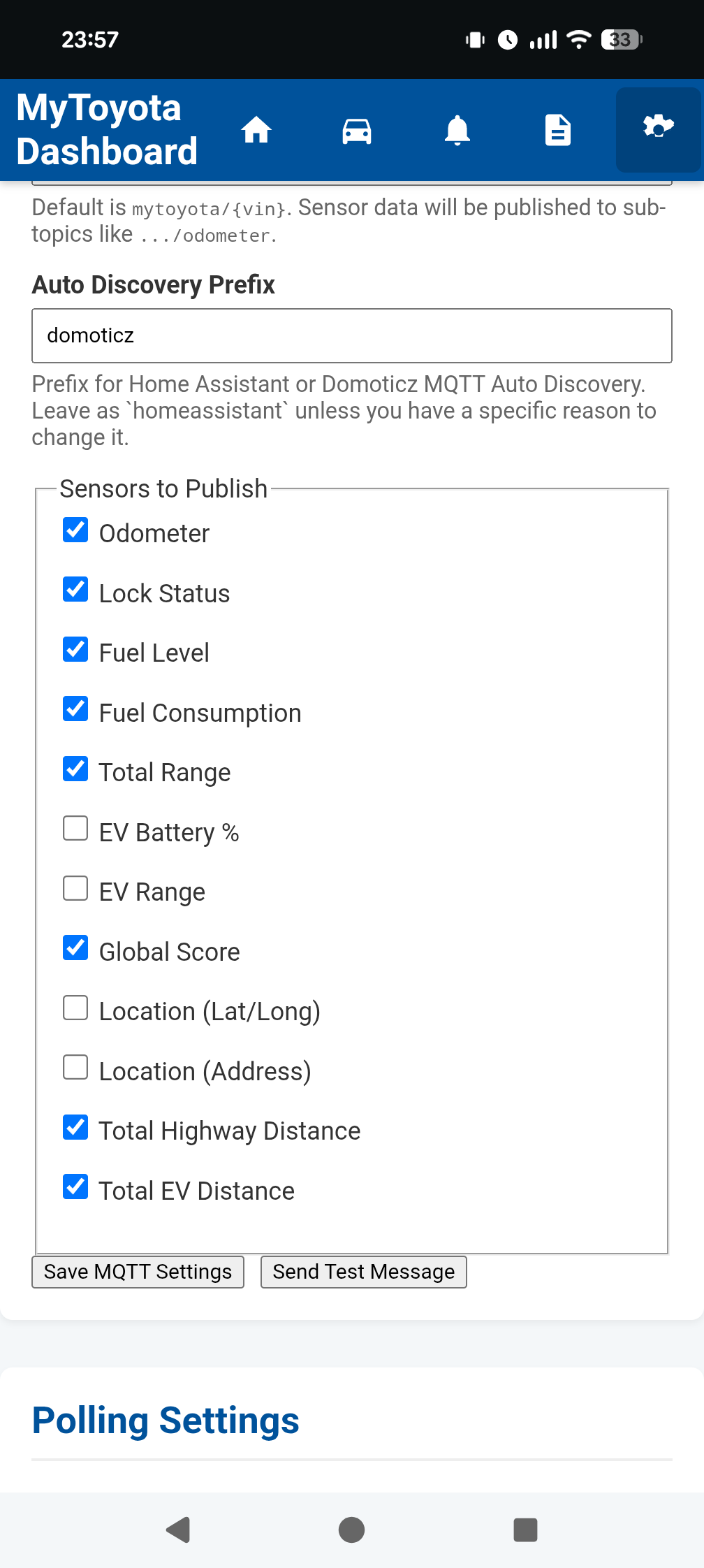

I added several new mqtt sensors which you can enable in the settings.
The address sensor doesn't seem to work yet, it's being send, but domoticz is ignoring it. All other sensors work though, including long/lat location.

Yes, you should see the same sensors as in my screenshot
