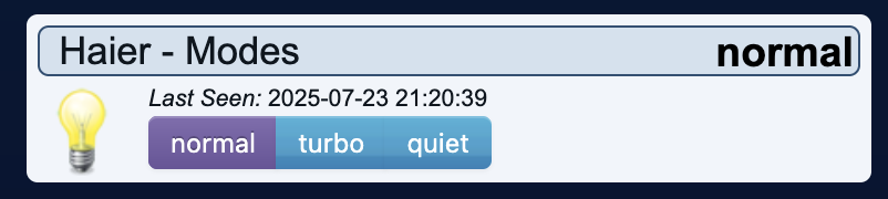

eddieb
Posts: 347
Joined: Wednesday 04 July 2018 7:48
Re: Python Plugin: MqttMapper
Post by eddieb »
playing around with MqttMapper made me really happy today ...
But,
is it possible to set the device icon in the config.json file ?
same for "Protected" ?
I only found examples of some options like LevelOffHidden
"options": {"SelectorStyle":"0", "LevelOffHidden": "true", "LevelNames":"Off|normal"},
but where can I find more "options"
RPI4 Beta / Tasmota / ZigBee2MQTT / P1meter / Haier AC with Node-Red and MQTT / SolarEdge SE3500H modbus_tcp / Opentherm gateway / Plugwise Anna/Smile / ObserverIP weatherstation thru WuDirect

FlyingDomotic
Posts: 396
Post by FlyingDomotic »
Icons have their own life in Domoticz.
Some devices (like switches) icons can be set into device parameters.
If you don't want to use default (or use a different) one, you have to do it with a script.
Here's is a script I use to change device icons for a selector:
	active = true,
    on = {devices = {"mySelector"}},
	execute = function(dz, item)
        local icons = {
			[0] = 140, -- Off
			[10] = 137,-- Auto
			[20] = 138,-- Manuel
			[30] = 139,-- Vide
        item.setIcon(icons[item.level])
Before creating it, you have find (or create) incons and install them into Domoticz, to get their id ("setup" > "more options" > "custom icons")

eddieb
Posts: 347
Post by eddieb »
tnx for the suggestions but this is not what I am looking for ...
a list of all "options" that can be used in MqttMapper.json while creating a device ...
that is not documented on the MqttMapper documentation and would be very nice to have.
Feeding ADSB https://adsb.im/home

I have the following json description
        "Modes": {
                "topic": "myhome/topic/Modes",
                "type": "244", "subtype": "62", "switchtype": "18",
                "options": {"SelectorStyle":"0", "LevelOffHidden": "true", "LevelNames":"Off|normal|turbo|quiet"},
                "mapping": {"item": "", "default": "0", "values": {"Off": "0", "normal": "10", "turbo": "20", "quiet": "30"} },
                "set": {"topic": "myhome/topic/set/Modes", "retain": false}
which gives me
Screenshot 2025-07-23 at 21.26.21.png (37.72 KiB) Viewed 638 times
that is exactly what I want and it works as I expect.
python checkJsonFiles.py --trace
checkJsonFiles V25.6.24-1 - Use --trace to get details
Input file(s)->['*.json']
Information analysing V1.0 file Haier.json
   Warning: switchType should be 0, not 18 for type 244, sub type 62 for Modes
If I change the definition I get a different switch but not what I need ...
Of course I am the one doing something wrong, or is it the syntax checker ?

FlyingDomotic
Posts: 396
Just replace "switchtype": "18" by "switchtype": "0" in .json file...
