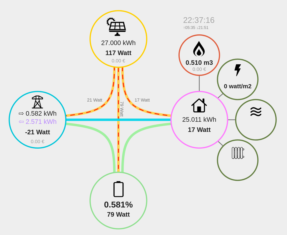

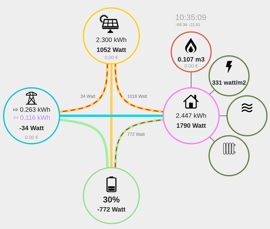

Problem is the way the enery flow to/from the battery :
	"MPWR": {
		"topic": "Marstek",
                "key":"MPWR",
		"type": "248", "subtype": "1", "switchtype": "0",
		"mapping": {"item": "params/r_data/2/value", "multiplier": 1, "digits": 1}
	"MSOC": {
		"topic": "Marstek",
		"key":"MSOC",
		"type": "243", "subtype": "6", "switchtype": "0",
		"mapping": {"item": "params/r_data/1/value", "multiplier": 1, "digits": 1}
In this case the battery is loading ( - minus sign)!
SOC works great , but flow is the problem now

The value in Mqtt message is -negative (minus)
This can't be changed.
I used device type : 248/1/0
i cant change any device setting
When changing to type : 243/29/0 i get 2 values , both negative.
I can change the setting to usage/return and from device /calculated.
But changing these values has no effect.
Edit :
Maybe we need a battery device in Domoticz ?
Editje :
There isn't even a Battery icon..
Edit 2 : SOLVED
I set the mapping / multiplier to -1
now it works !
